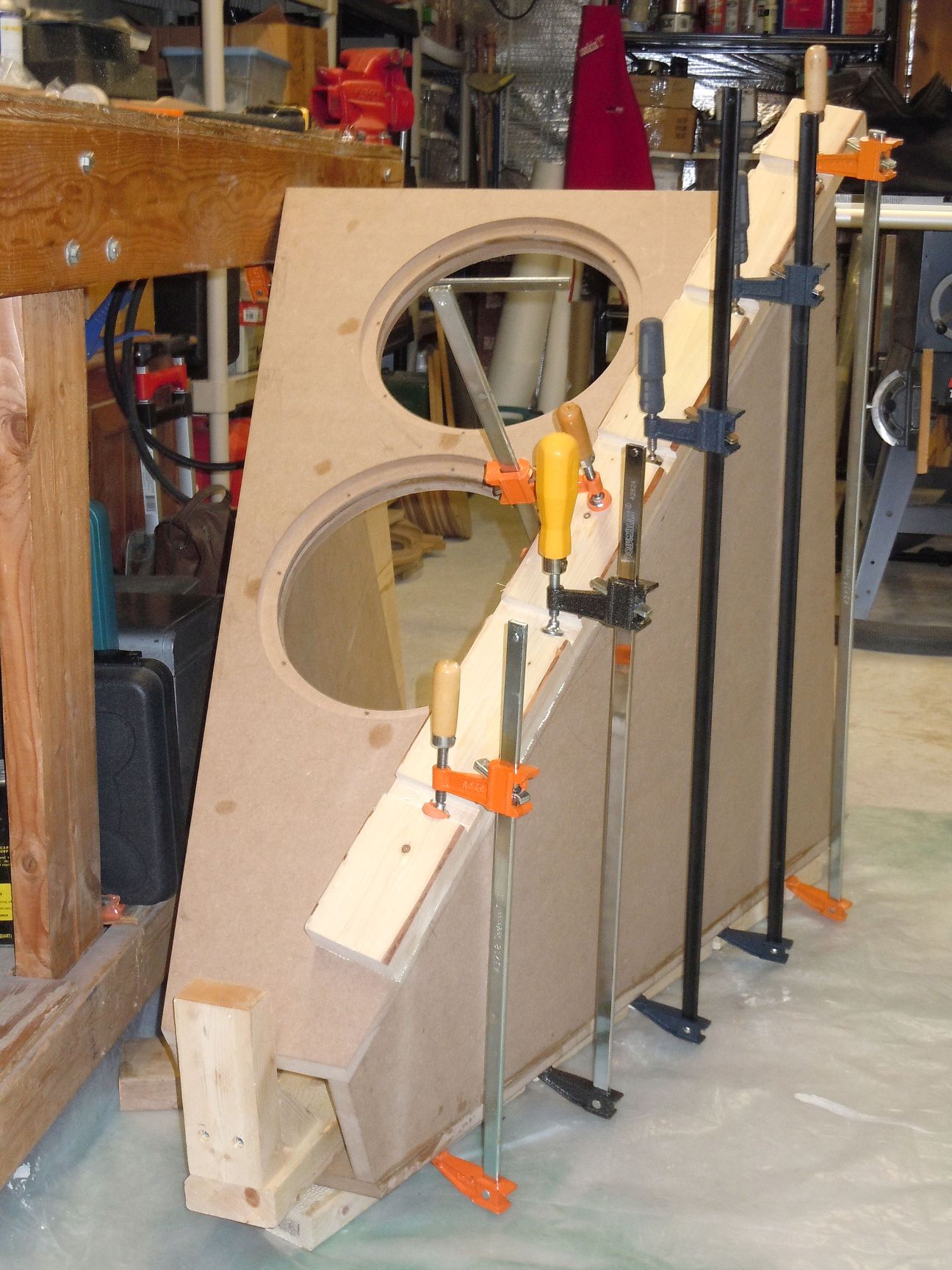

After having built the truncated pyramids for my egg project I can say that you will face at least two problems making that sturcture. The first is setting the proper angles for the cuts. In the pyramids there was not one single 90 degree cut so I purchased a Wixey WR410 8" digital protractor to set the blade angles on my table saw. Don't even think of doing this with a hand saw. With large pieces even a small angular error can lead to large misalignments.
I almost always use biscuits which are great with straight surfaces. Even angled surfaces are not a problem as long as the pieces are of consistent length. When you get a shape such as the pyramids or your horns you wind up with two problems. The first is that clamps tend to slip off the surface. The second is that when pressure is applied, the pieces tend to slip along each other which is the thin direction of the biscuit, offering no resistance to that slip. I think I would go with the screw method suggested by Dave. The entire egg project will be in three issues of audioXpress starting with the September issue. Here are photos of two of the jigs I used when gluing the pyramids. BTW, the egg project was the most difficult woodworking project I ever did and from start to finish including the electrical design took about a year.

A thought just popped into my head. I almost always use MDF, not plywood. The screw method works in MDF but it is more difficult to get accurate alignment when drilling pilot holes in plywood because of the differences in layer density and grain direction. You might want to try a hybrid solution with mostly biscuits for alignment and just to keep the panels from sliding during gluing using one or two screws away from the ends to minimize splitting. Pilot holes for those screws would be necessary but you could drill them after the biscuits are in place and the panels joined dry. After the pilot holes are drilled the panels can be separated and the glue added before reassembling the panels. That would give a better chance of registration of the screws and less chance of them screwing up (pun intended) the overall registration. You would still need to clamp while the glue is setting up requiring the jigs in the picture that would keep the clamps from sliding off. They were pieces of 2 X 4 with slots cut in them for the clamps. The material used in kitchen shelves to keep things from sliding was hot glued to the side facing the work to provide additional grip and a clamp was used to fasten the jig to the work.
