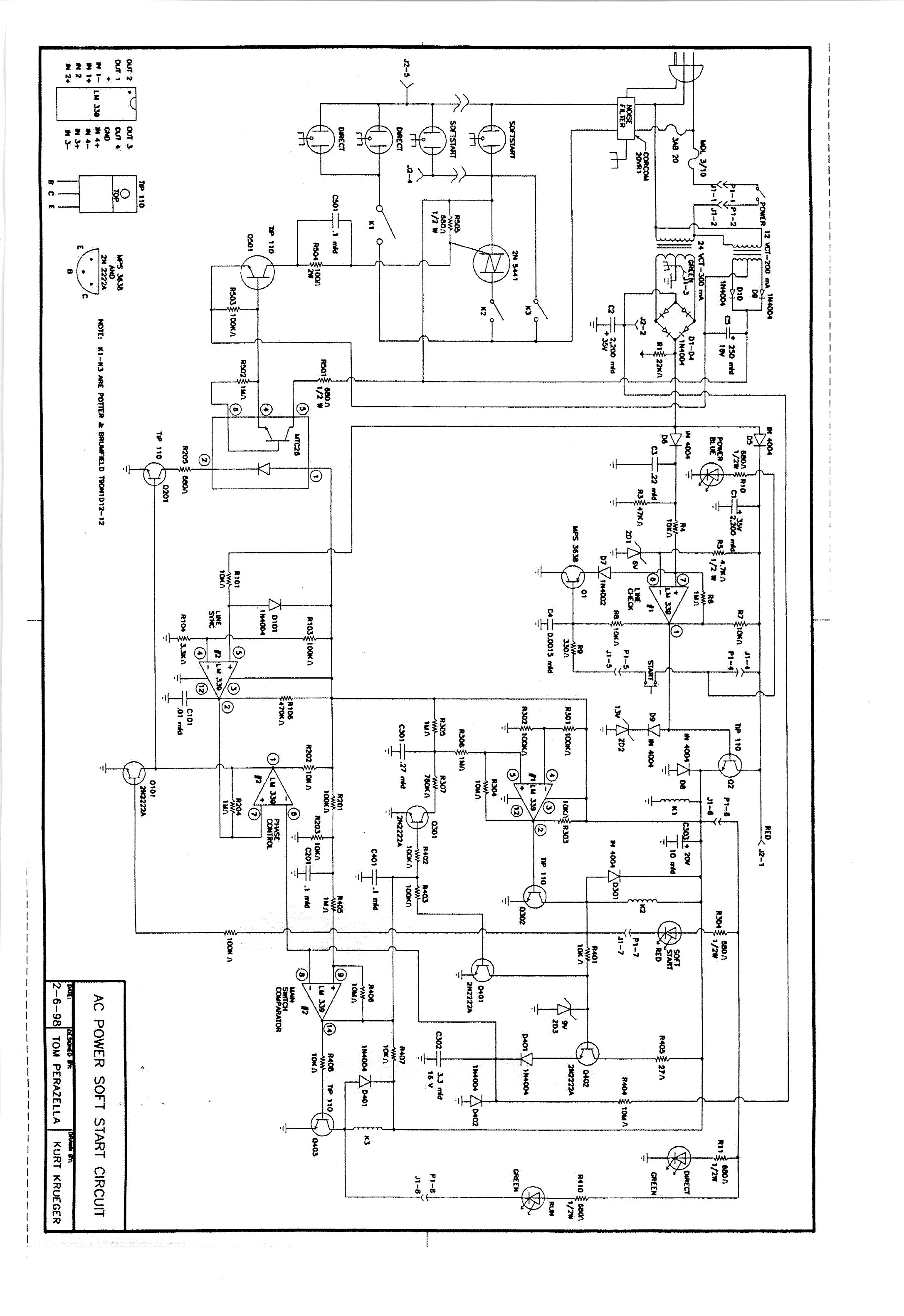

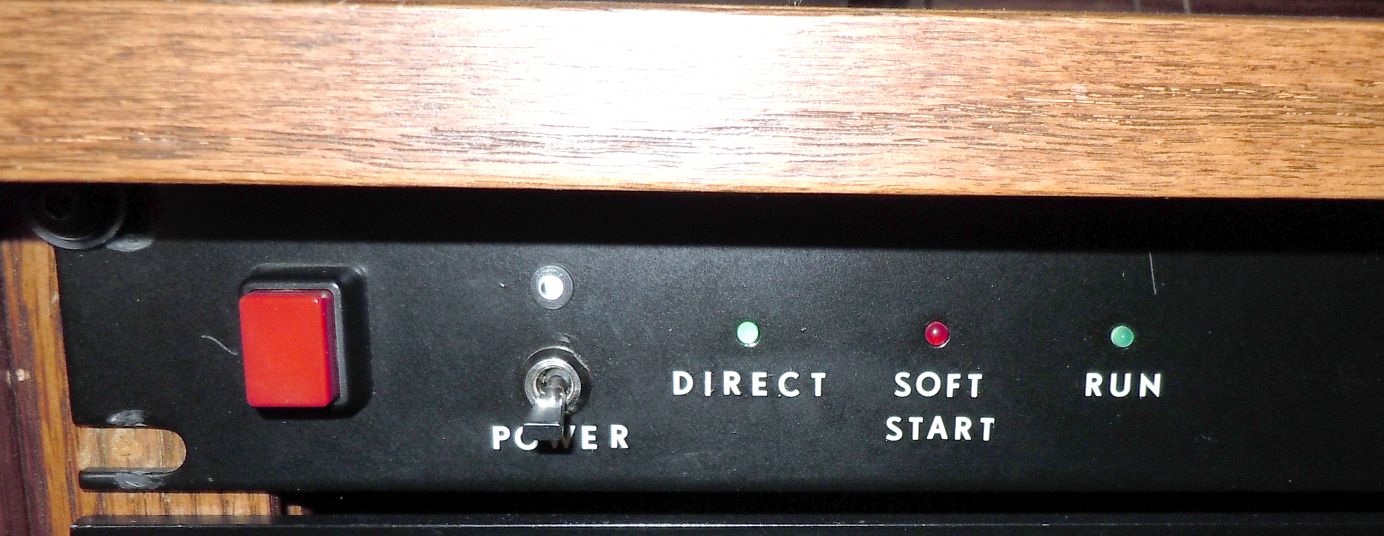

A number of posts have mentioned the problems with high inrush currents affecting the line voltage and causing stress on components when initiating a cold start. Here is a circuit I designed about 20 years ago that addresses that problem. I use it in my main system that has 4.6KW of power amplifiers plus all my other equipment. It all runs on a shared 15 amp circuit in my home and I have never tripped a breaker nor had a component fail from inrush currents.
The output is divided into two sections. One is soft start and the other is an instant on for devices that are sensitive to the rate of rise of the power supply voltages. I had some components where the LCD display would not come on with a soft start. In addition, it looks at the line voltage and if it is above or below set limits the supply turns off. It is a latching circuit so if it detects a line anomaly it will stay off until the start button is pushed.
The soft start sections run through a phase control circuit much like an automatic wall dimmer. When the phase gets to full, the triac that drives the phase control is bypassed by a large power relay and the phase control circuit is disabled to minimize any switching noise. There are LEDs that indicate the various states including power on, soft start, and run.
All the voltage sensing and timing for the phase control are done using LM339 quad comparitors. The triac is a 40 amp device mounted on a relatively small heat sink because it is used for only a few seconds. To provide the highest di/dt protection and to assure no dropout of the triac with inductive loads, the triac is driven by a synchronized DC pulse with a high initial current charge to the gate by a capacitor that bypasses the gate current limiting resistor.
All of these devices or more modern equivalents should be readily available. Total cost should be relatively low. The chassis and outlets should be some of the highest costs. To minimize chassis work in mounting a lot of outlets, I simply mounted 4 multi outlet power strips on the chassis and wired them to the internal circuitry. I'm including images of the schematic, the power outlets on the chassis and the control panel.

The problem with that Tom is that power amps. get bogged down by anything between them and the receptacle. When I had my 400-watt/channel Thresholds any conditioning -- even high-current 40-amp. rated Corcom filters and the like, would screw up the performance. Even my Carys, that need only about 10% of the 120-volt power that Thresholds demanded do not like anything in the way. Power amps need a low source-impedance power supply to perform properly. And that experience is based on a dedicated 10 AWG power feed from my panel-board. Not to mention that the 13-kVolt sub-station transformer is only 50 feet from my service entrance.
