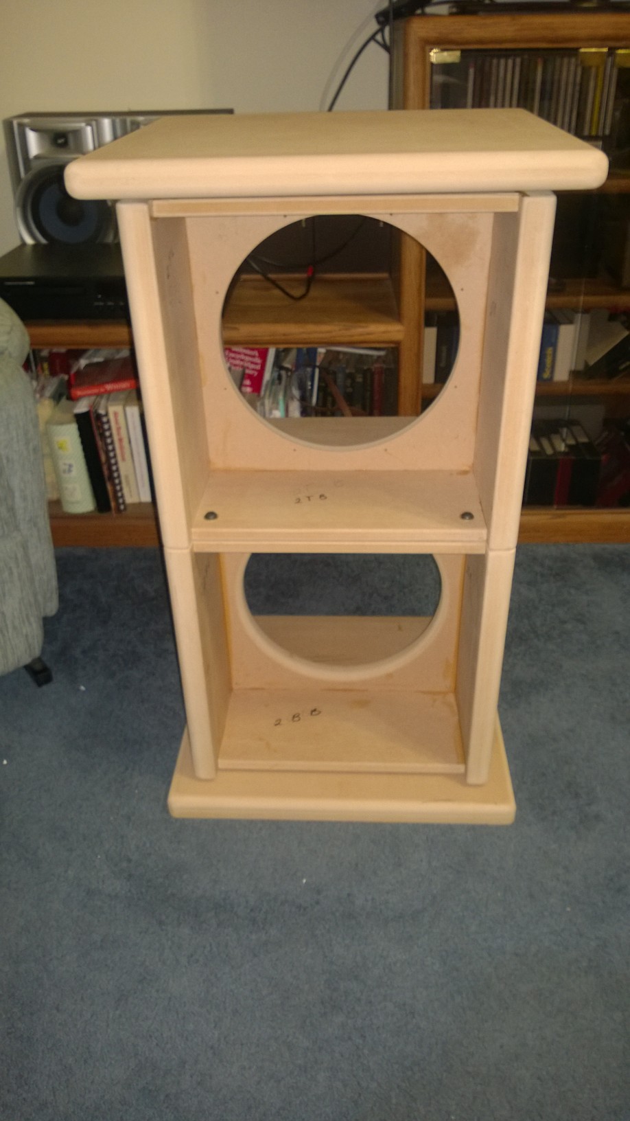

Test fit the first cabinet together and looks good. Time to build the second one. Now that Snowmageddon is here probably not going anywhere soon.

For open baffles glue is enough since the forces on the joints are not great. If you are using mdf for a closed box system in addition to glue I would use confirmat screws.
https://www.amazon.com/HighPoint-Confir ... B0031TGSB2
They are especially made for mdf.
PostPosted: January 4th, 2018, 9:56 am
Thanks for the tips.
Have a finishing shop that is going to paint them hot rod black as they are doing for my 6x12 cabinets.
I had an auto body shop paint my eggs with the same PPG black metalic paint that is on my wifes car. After seeing the photos of what he went through you don't want to try it yourself. To get a smooth finish across the glue joints he had to use something known as icing in the trade.
PostPosted: January 4th, 2018, 10:36 am
Otherwise known as "Bondo" or "mud."
PostPosted: January 4th, 2018, 11:16 am
Posts: 943
tomp,
That is why I am having the auto finishing shop do mine. The test they did on my other cabinets looks really good. They have a massive paint facility that will even fit MACK trucks. They can do the entire cabinet painting at one time.
I am happy to have them do it.
