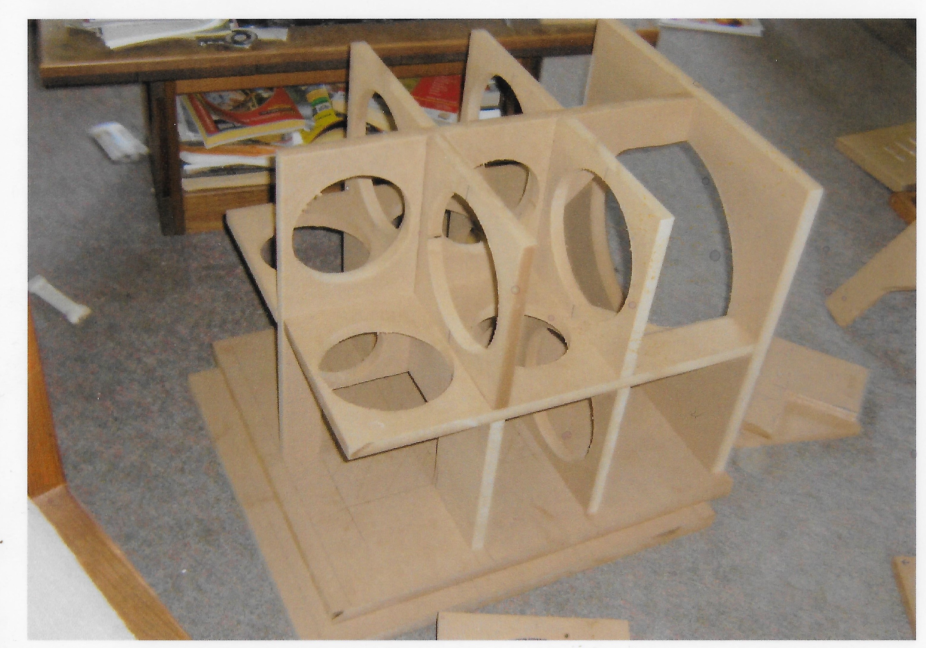

If you can get the baffle off and gain access to the inside of your cabinet, you could add a skeleton like this:
Then put some stuffing in there.
The stuffing effect on the driver that the engineers are talking about will more than counteract the loss in volume from the skeleton.
Depending on your listening sensitivity, and the characteristics of the sidewalls on the existing cabinet, it might not be magic, but it will pretty dramatically change the behavior of your cabinet.

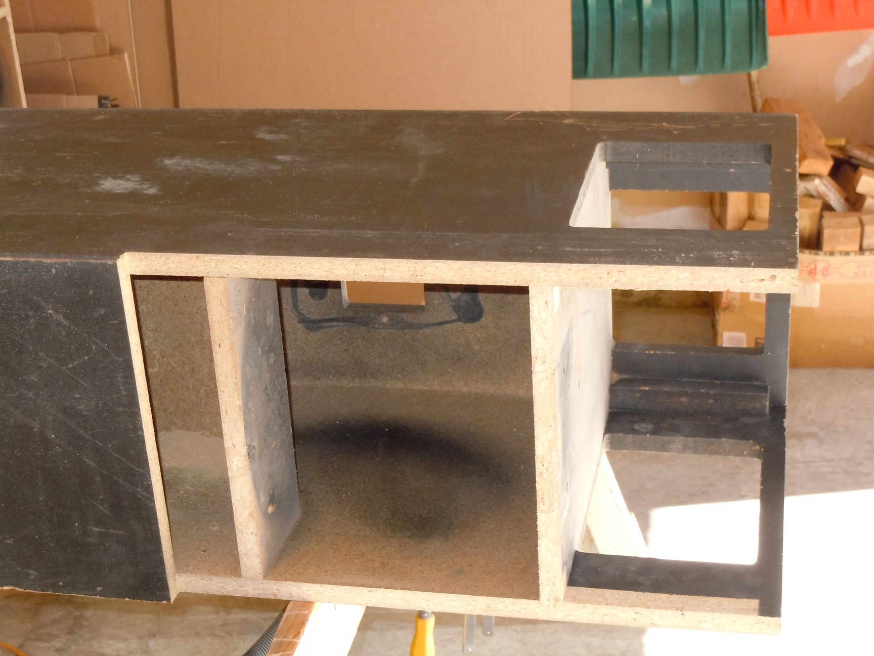

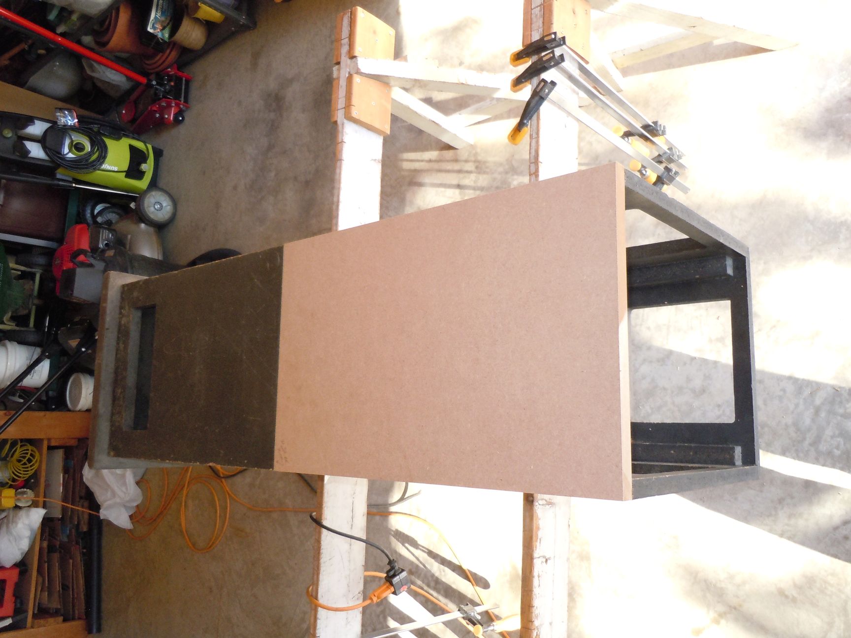

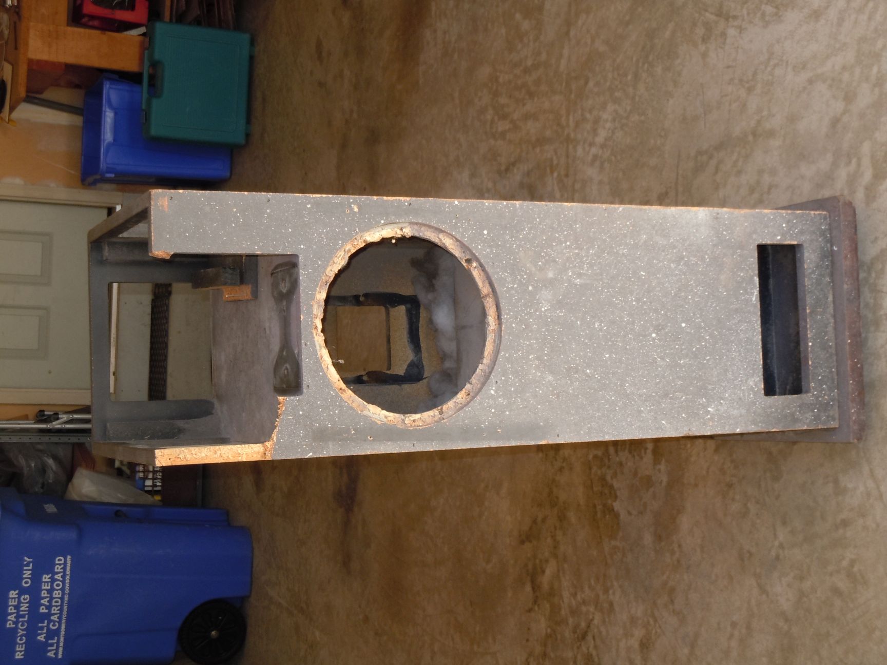

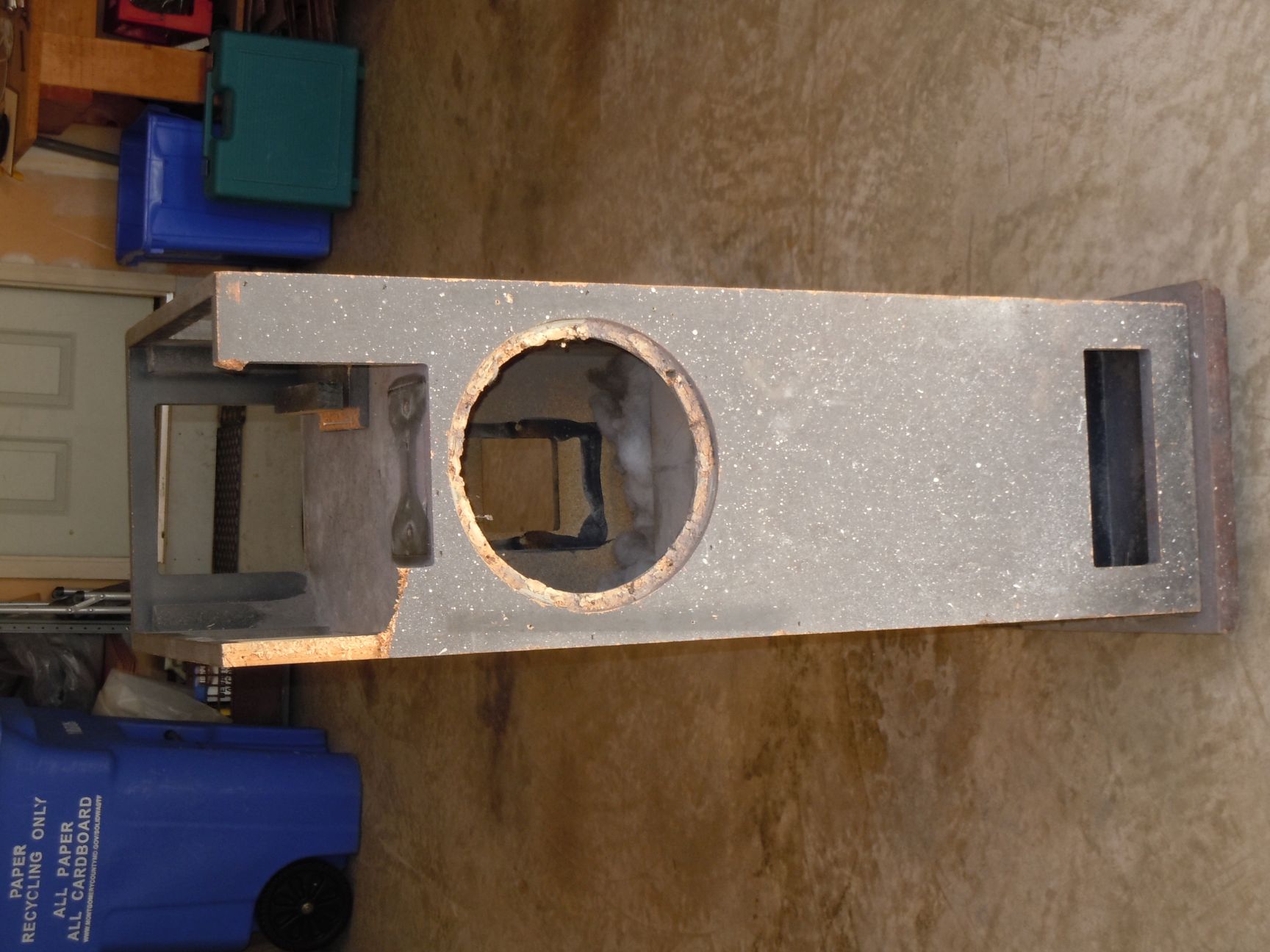

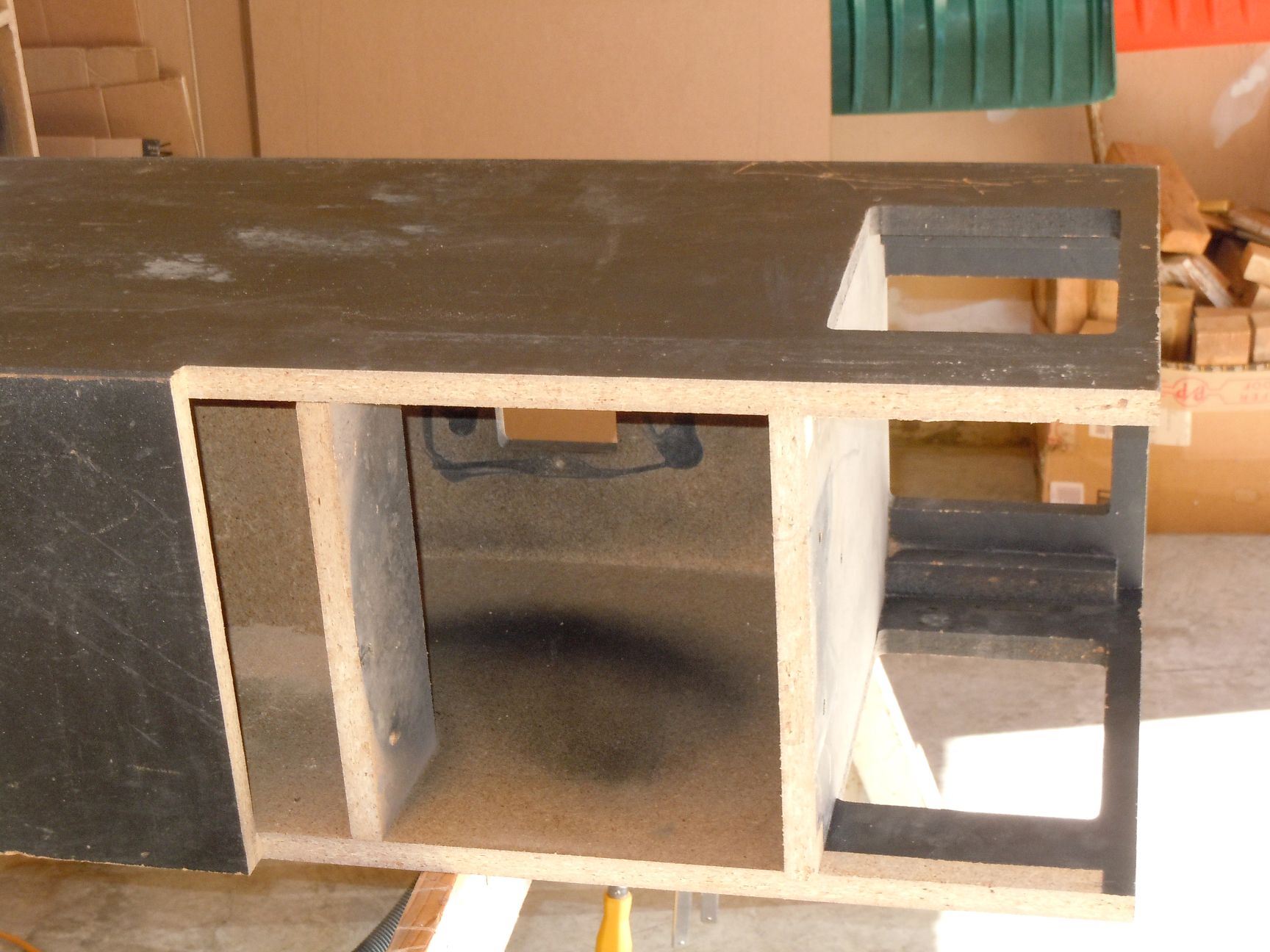

The best way to remove one of the panels is to use an edge guide and a router with a straight bit. It will make the straightest, cleanest cuts. I'm in the process of restoring a very badly treated Heil AMT tower for a friend and had to remove half of a front panel that was a complete mess. I used the router and it worked fine. Reassembly of the new piece was done with glue and biscuits. Here are some photos.

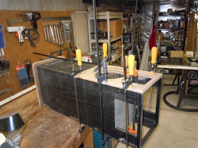

Here is the new front being attached.

That's the best and neatest way to do it.
I'm going to have to do the same thing to my Janis W1's. When I was young and dumb I stupidly glued the bottom thinking it was a good idea that would add strength. What was I thinking. It now 32 years later and now I want to make a change
PostPosted: November 18th, 2017, 9:59 am
I also used to young and dumb. Now I am just dumb. I might not be evident in the last photo but if you look carefully just under the front most clamp you will see a pink colored line. The significance of that is when I cut the slots for the biscuits, on the bottom section of the new plate I cut the slots on the thin edge as needed. I then proceeded to cut the slots on the sides on the same thin edges when they should have been cut on the back surface to mate with the thin edges of the box. DUH!!! When you get tired you tend to do dumb things. The pink lines are the Bondo I used to fill the errant slots before cutting the correct ones. Bondo is an old farts best friend.
