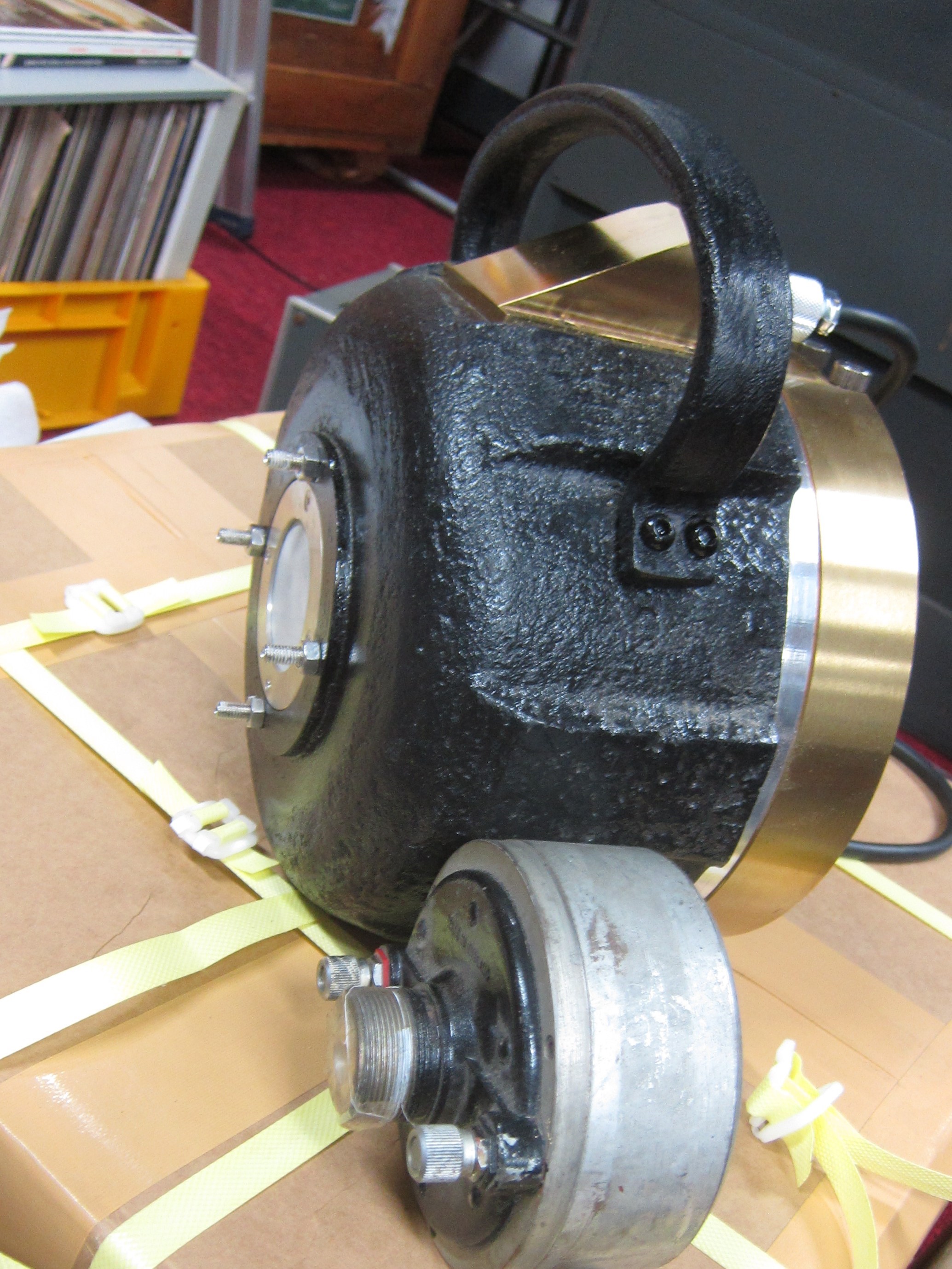

Found a few sweeps of the KL horn with a GIP replica WE594A beefed up with 20 extra pounds of permendur.
The red curve is on axis at a couple feet, the yellow curve is way off axis maybe 45deg @9-10 ft. Not referenced to 1V, we were just messing around trying different things I think the blue line may have been a real 594A on a 31A horn.
These sweeps are unsmoothed, BTW.
The big black driver in the pic is the GIP modified 594A.
