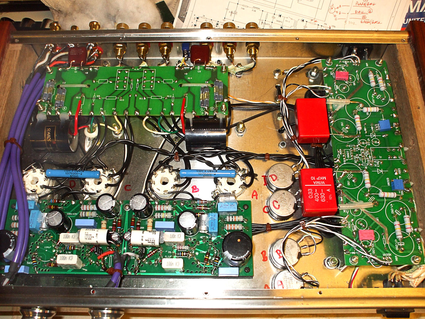

A word of advice. If you have a power amp. with bias pots buried inside the chassis it is a worth while project to replace those pots with top mounted pots that are easy to get to for dialing in the output tubes. The attached photos show what I did and it saves a lot of pain from upending an amp. -- removing the bottom cover -- and making changes on one's work bench. As a DIY nut job I was able to tube-roll to my heart's content -- no muss -- no fuss.
