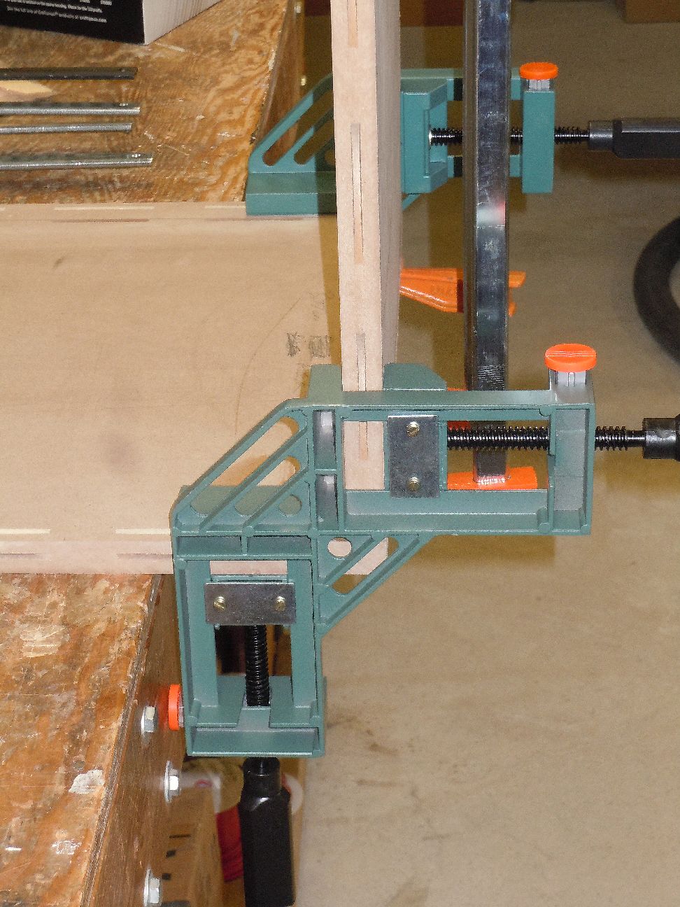

I have tried screws and they suffer from the same problem as biscuits and in addition have the requirement to fill the holes after the screws are used. Those fills are just another thing to sand. The pilot holes provide the same locating properties as biscuits but have the same drawbacks. If they are not perfectly aligned when you draw the screws down tight there is no way to correct for a misalignment. With biscuits, since they fit into a slot you have no movement capability at all across the slots but some very limited movement in the direction of the slots. The other advantage of using a plate joiner is that the ability to precisely control the position of the slots is far greater than with a drill. There are both coarse and fine adjustments built into the plate joiner to precisely position the locating fence on the work. Both methods work and are better than unsupported joints. All of my speaker construction including large sealed box subs have been made with biscuits and I have never had a mechanical or containment problem.
If anyone would like to try biscuits I have a Porter Cable plate joiner they can borrow. I have also fashioned a hose connection from it's exhaust port to a standard shop vac hose. As Jeff said the dust is a problem and all of my tools have vacuum connections to my shop vac. That even extends to my sander. I'm enclosing a photo of two MDF pieces that have had slots cut into them and are being glued while being positioned with corner clamps and a PDF file of some of the adjustments of the plate joiner.
