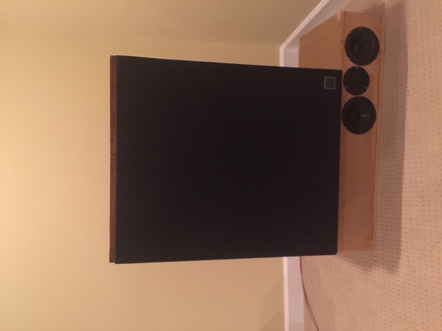

Funny you posted while I was getting ready to post.
one of the 802D driver is not working. There is no continuity between the terminals. So, got an original 511 with 802D driver on Ebay, which is sitting on top of the speaker. Using N-500D crossover.
Initial impressions.
I never heard the dynamics like this before. They just draw you into the music, I often find myself listening to music for hours. Little harshness on the high frequencies which is tamed slightly by the grill (see photos with and without the grill). Bass is very tight and goes down to 30Hz. Piano sounds like a piano.
The cabinets are sealed, having trouble getting the horn out for replacement. Back wall of the speaker wont pry loose.
Roscoe, how do you describe difference between 511 and 32s?
In an another forum folks suggested building the midrange attenuated 30904. Got the parts for it, may be next weekend.

Oh yeah, forgot about those "special" woofers. Don't see too many around. They could be very interesting!
Your speakers look like Altec Santiagos.
The EQ crossover is a good idea generally. The idea is to drop the mids so that the HF looks peaked. The midrange efficiency thrown away to achieve the curve is totally excess to needs anyway.

These are larger than Santiagos and the horn is 511B instead of 811B. I could not find a spec sheet to match them.
