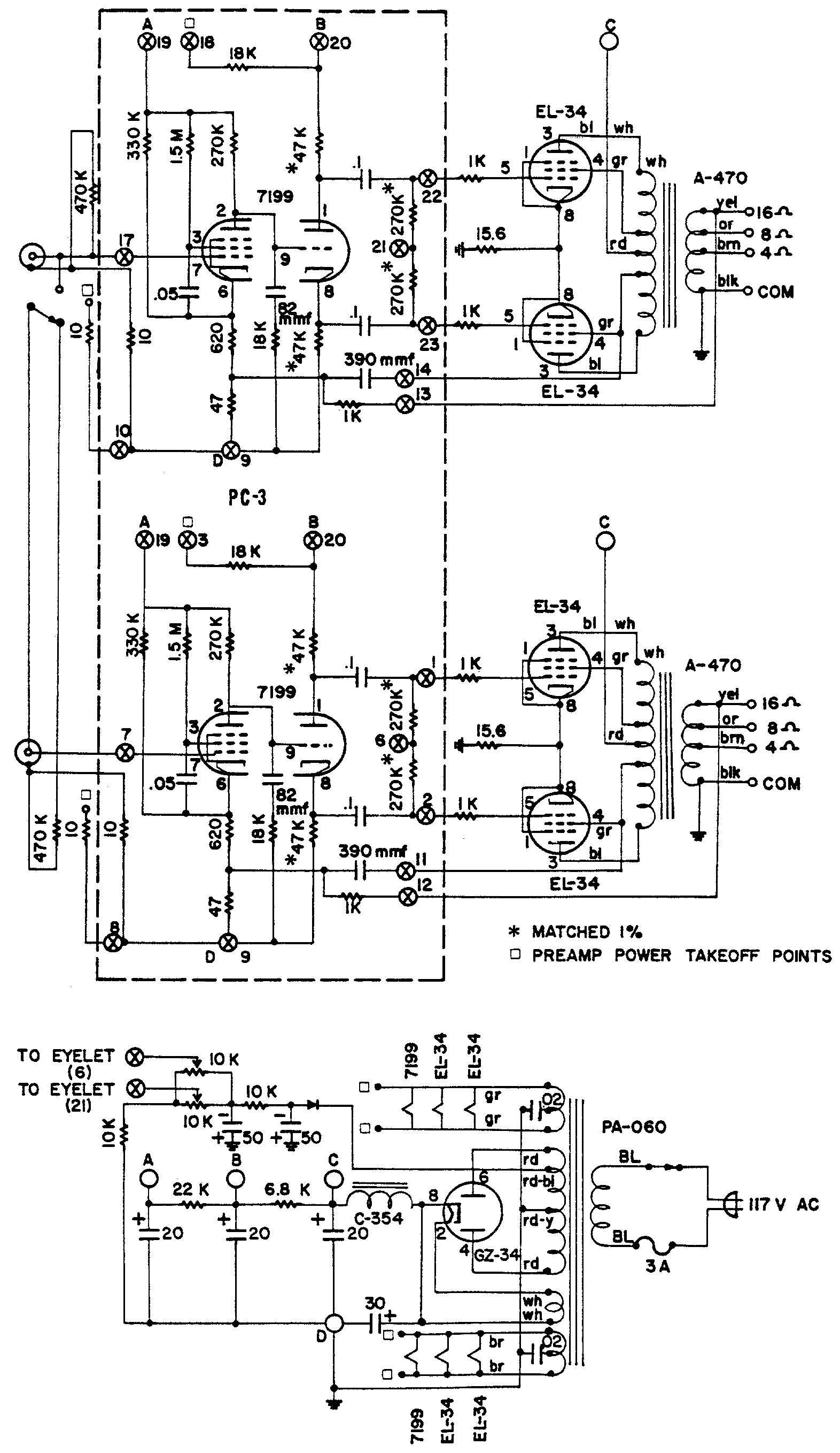

Hmm, if all the tubes went dark, did you check the fuse? I think there is a 3-Amp fuse in the primary of the power transformer. There is schematic attached to this post. If the fuse is good, the tube heaters should light up unless the power-transformer primary and/or both heater secondaries burned out. If you have a multimeter you can carefully check the primary AC voltage and heater AC voltages.
File comment: Dynaco ST-70 Schematic

Yeah, and everything inside the dotted line needs to go :o

Okay, so if you unplug the amp from the wall and measure resistance between the two prongs of the wall plug, you should see low resistance (< 100 Ohms?) If not, then the fuse is bad, a wire is broken, or Roscoe is right and the primary is open so the power transformer should be replaced.
There is a section on troubleshooting in the kit manual, and it shows pictures under the chassis. Take a look and maybe the fix is easy! It's usually good to have the unit working before modifying it so you can assume any problems are caused by the new modifications.
Go to <http://www.dynaco-doctor.com/st7_mnl.pdf> to download the manual (look around this site, too, for information.) The troubleshooting section starts on page 9 (Page 13 of the PDF.) www.dynaco-doctor.com Also has a repair guide from Curcio - take a look!
If your amp is stock, there is also a selenium rectifier in the bias-voltage circuit. This should be replaced with a solid-state diode like the 1N4007. Selenium is nasty.

Okay, so if you unplug the amp from the wall and use a multimetere to measure resistance between the two prongs of the wall plug, you should see low resistance (< 100 Ohms?) If not, then the fuse is bad, a wire is broken, or TubeDriver is right and the primary is open so the power transformer should be replaced.

A good cheap tool useful for testing amps where a power problem may exist is to make up a fixture that has a light bulb such that the amp can be powered up with the light bulb in series with the power. A lamp with one of the power conductors is cut and a male AC connector bridges the two ends of the cut wire serves as the socket to plug the amp under test into. This is also useful for reforming capacitors in amps that have not been powered up in a long time. IF the lamp comes on very bright there is a short in the amp's power supply or transformer. If the lamp dims shortly after turning on, this usually indicates that things are OK to remove the lamp and plug the amp directly into the wall outlet. Do NOT do this with switching power supplies. Typically I use a 100-watt lamp.
