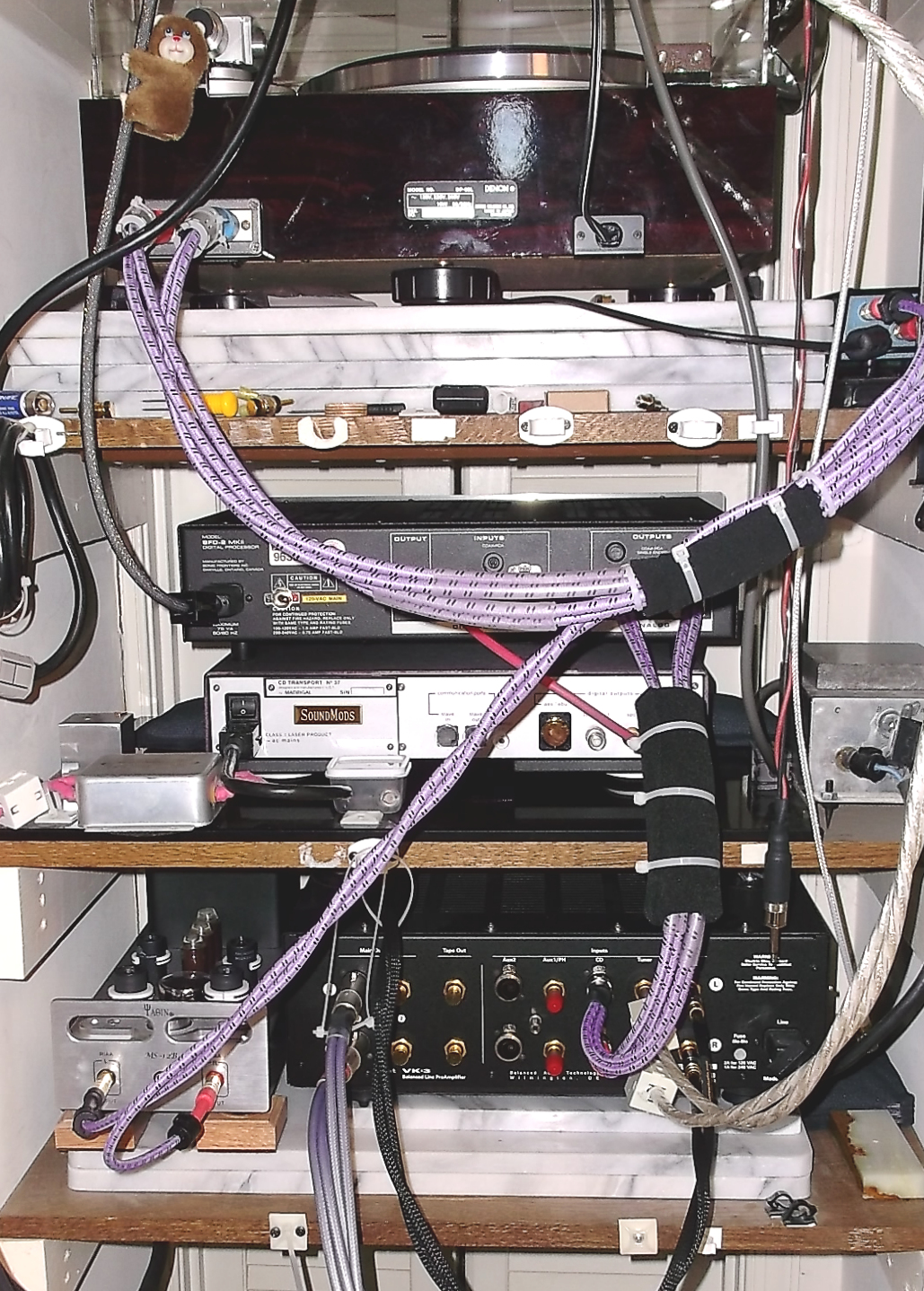

Then there is micro-wave cable like the W.L. Gore Phaseflex. I've cabled up with that stuff and in a shoot-out with Nordost Odin the Gore won big time.
A buddy of mine has had the same experience. The Gore stuff can be found on eBay in the form of used surplus. It's not cheap and it's a pain-in-the-ass to terminate -- but OH BOY!!
I've done singles and shot-gunned it for balanced line. Awsome stuff for audio! :thumbup:

Very interesting! I would like to give this a try... Is that the wire you are talking about? http://www.ebay.com/itm/Gore-Phaseflex-65474-30-9m-Type-N-Connector-Microwave-Coax-RF-Braided-Cable-/152115147495?hash=item236ac4f2e7:g:9-YAAOSwepJXUnG5

Yes. That's it. You found a nice offering. Go for it.

If my system was solid-sate based and DC coupled it would be fun to set the connection impedance to 50 or 75-ohms based on 50 or 75-ohm cable. The Phaseflex has a characteristic impedance of 50-ohms.
Oh well -- I am addicted to vacuum tubes -- they serve the music so well.

So this Gore Phaseflex would not work well as interconnects for tube gear (e.g. phono stage to line stage or line stage to amp)?

I think you may have misinterpreted my impedance comment.
Let me put it this way -- there are no interconnects on this earth that match the impedance of any audio equipment other than digital interconnects that match up with the 75-ohm SP/DIF characteristics or the 110-ohm AES/EBU characteristics. Of course there are professional systems with balanced lines that match up with transformers, but that is another area altogether.
It would be an interesting exercise to modify a direct coupled solid-state pre-amp with a 50-ohm source impedance (provided its output stage can drive a reactive 50-ohm load) and modify a power-amp with a 50-ohm load impedance than hook them up with Phaseflex that has a characteristic impedance of 50-ohms. That could be the ideal interconnecting scheme. Yes? No?
I am using the Gore Phaseflex pretty much everywhere. All of my stuff is vacuum tube as is the my friend's stuff who also has discovered the Gore Phaseflex. Like I said -- it is a royal pain-in-the-ass to terminate, but OH BOY! The sound reproduction is top notch. Those cables simply step out of the way. :D
Actually, if it wasn't for the U.S.S.R. and U.S. military and aerospace requirements I would not have the really cool surplus parts, cables, and tubes that have transformed my audio system over many years of addictive DIY meddling. :crazy:
