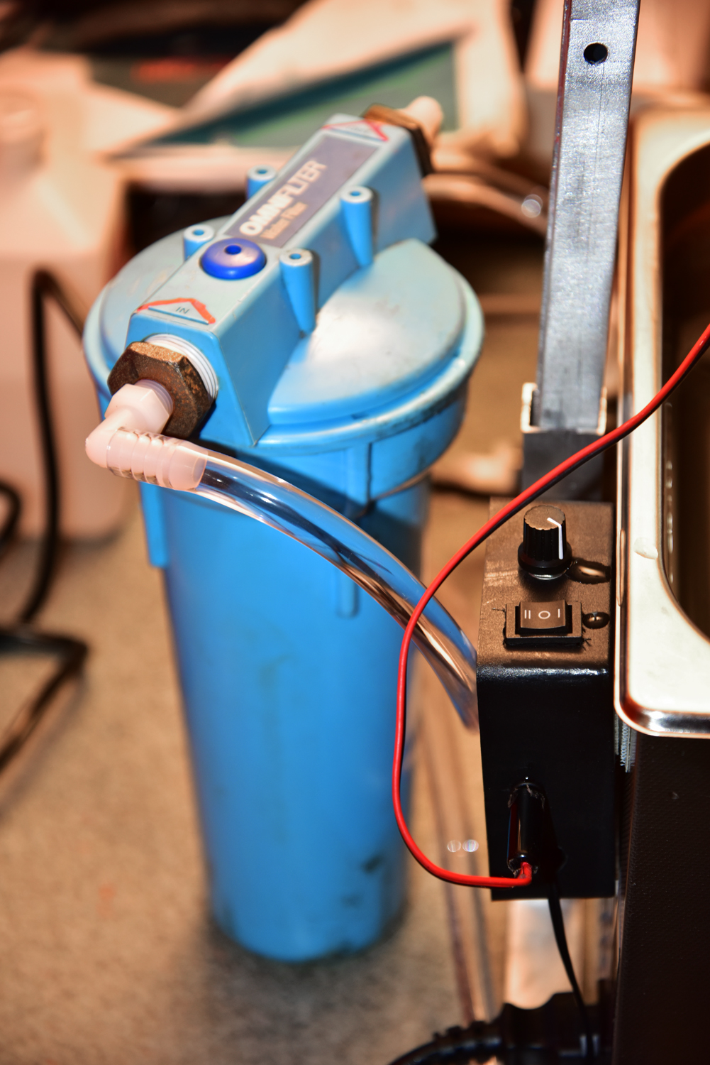

I added the pump and filter. I will probably be flamed for the filter. My goal was to hold cost down and I already had the filter canister on the shelf. I can get a pair of 5 micron filters for less than $10 at home depot. I use them for my whole house filter system so they were on the shelf also.
What the commercial guys use is an aquarium filter that cost between $100 to $180 depending on the number of filter stages and GPH. I could not find any specs on how fine the aquarium filter was, just marketing goop. My $20 pump claims 225 GHP, I believe I am getting a refresh in less than 3 mins. I am setting the temperature to 37C which is 68F, a throwback to my darkroom days.

PostPosted: May 15th, 2016, 2:58 pm
Hmmm. I found a nice 2-stage aquarium filter for under $50. I try to keep the solids at a minimum by wiping the used records first.
