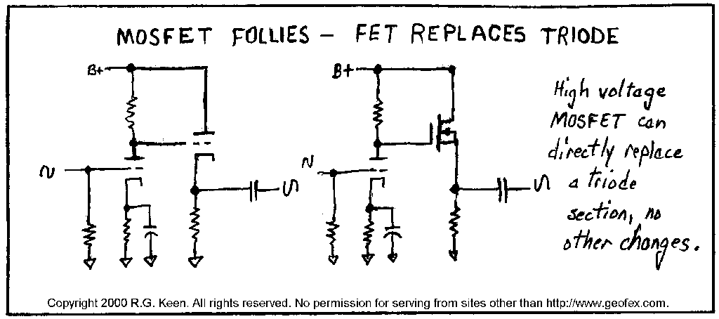

Without getting too complicated here, I'd suggest a slight variation of my original idea:
Leave the existing output alone. Add a second output using a MOSFET (selected for drain-source voltage 100V+ greater than your B+; and minimal input capacitance) as a follower (source, instead of cathode). Connect the drain to B+; the gate to the plate of the gain stage, with a protection diode from drain to gate, then a big resistor to ground, from the source. Select the resistor for 10mA or so. Source connects to a series capacitor (your new 10uF cap) the new output jack.
Virtually zero load on the triode (and BTW, the 6BQ7 is a very nice sounding tube!), new output has no effect on the existing circuit, so long as the power supply can handle another 20mA or so.
The existing cap and it's sonic signature are left in place. The new output coupling cap can be compromised a bit if needed to control cost, since this output is intended to drive a bass amp only. Metallized polypropylene should be just fine, just avoid Solen Fast Caps.
In the picture attached, you will have BOTH outputs. One, a triode, to your high frequency amp, and one with the MOSFET to your bass amp.
On the subject of gain pots: none are perfect, good ones are expensive (P&G or autoformers), or difficult to implement LED optocouplers). If you don't need one, don't add one. Crap ones, and even good ones WILL degrade your system sound, it's just a matter of degree.

Stuart's idea is good in principle, but caution is in order. It appears that there is a muting relay for the output with perhaps a timer that allows the voltages to stabilize in the preamp before allowing the output to be active. Without muting, there is a risk of destroying ss amps and speakers as the output voltage wanders around during warm up. If you do something like Stuart is suggesting, you probably would need a second relay for the additional outputs.
Thanks, David. You're right! I assumed tube rectification and long TC filtering! Forgot to look. Muting outputs during turn on/off is always a good idea!
On the subject of output coupling cap size, and for what it's worth, I prefer output cap sizing to keep F3 below 3Hz, even below 1Hz if practical. In my system, I can hear the difference.
Trouble is, those caps are big, expensive and not as good sounding in the upper registers. So the dual output approach allows smaller caps in both locations as well as optimizing the HF cap for best performance.
