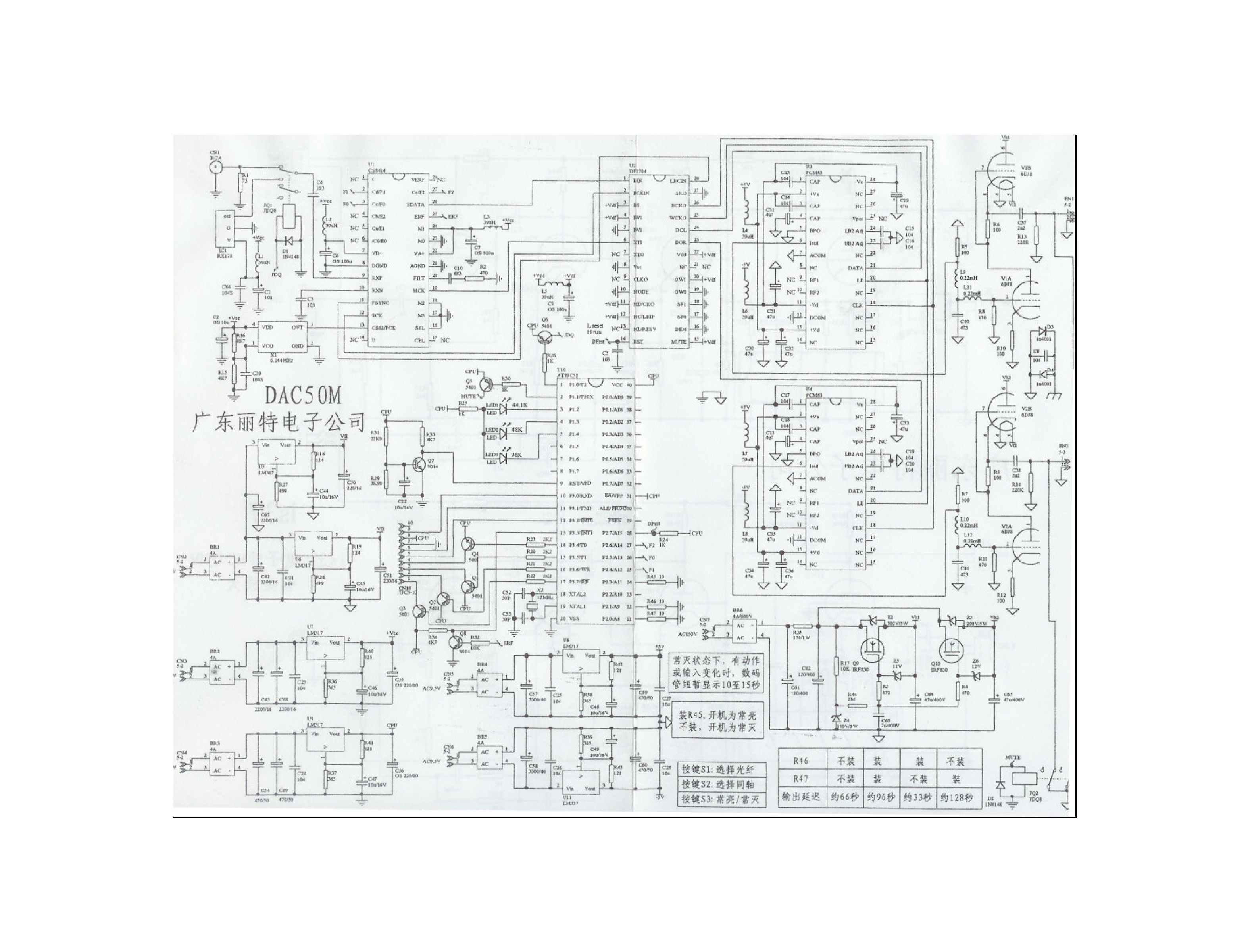

With the occasional addition of the Behringer DCX2496 to my system, I want to change to a balanced digital signal transmission format. The Behringer is still for developmental purposes, not intended to be in the system long term. But it does have a balanced digital input, so I want to take advantage of this by placing my Monarchy Digital Interface Processor (DIP, a re-clocking device) close to the music server, this providing the AES/EBU output, which will travel 40' or so to the DAC device.
When the Behringer is in the system, the AES/EBU termination is into the DCX2496. When it is NOT in the system, the balanced signal will terminate into my DAC, a China Lite DAC 50.
The Lite DAC 50 does not have a balanced input. I KNOW I can use an external balun. I don't want to. I would rather add an XLR jack if I can.
It looks like I would need a selector switch (SPDT), jack, bit of wire, a 110R resistor and a "pulse transformer", whatever that is.
I am attaching pictures of my schematic (sorry for fuzzy, but you can see the input in the upper left, simple RCA with a 75R load) and the alternate input I propose (minus the op-amps).
Will this work well?
Where would I find a quality "pulse transformer"?
Thanks from a digital moron!

Some folks are going all out with Lundahls, but Pulse, Tamura, and Murata should cover it for you. Most consumer grade DACs just terminate in a resistor, you're ahead of the game with a transformer input....
http://www.raleighaudio.com/installation.htm
http://www.diyaudio.com/forums/digital-line-level/261379-spdif-transformer-signal-quality.html
http://www.mouser.com/ProductDetail/Pulse/PE-65612/?qs=jQfFj0%252bz52LalKdxQ4le9A%3D%3D
http://www.digikey.com/product-search/en?pv69=6&pv69=80&FV=fff4000c%2Cfff80226%2C4ec001a&mnonly=0&newproducts=0&ColumnSort=0&page=1&quantity=0&ptm=0&fid=0&pageSize=25

Lots of good info there. The Newava and PE seem to perform the best. Lundahl did not look good.
Oddly DK calls the PE obsolete and there it is in Mouser. Hmm.
Making me wonder whether the input may overload based on some conversation in the Rakk Dak article.
PostPosted: February 12th, 2015, 9:51 pm
Posts: 308
Yeah, it depends on the input receiver. There are tons of other transformers with slightly different ratios, I filtered the results on the search I linked to only show 1:1 There were tons of 1:1.2 and 1:1.4, etc.
I like what the Raleigh guy did by keeping the 75 ohm resistor on the secondary, which looks like a familiar loading to the input on the CS4xxx receiver, but on the primary side it is transformed to 110 ohms. Nice trick!

Okay, parts ordered: Newava S22133 transformer, XLR jack and cable ends. Will install per the receiver chip manufacturer's recommendations. Cirrus CS8414.

I added a balanced input to my Lite DAC 50. I removed the optical input, did a little rewiring and used a Newava 1:1 transformer. Added an XLR jack and used the optical selector switch to choose between balanced and unbalanced inputs. Made a short cable using Tom's special Belden 110 ohm cable. DEFINITE improvement in sound!
Was cheap to do, not very time consuming, and worth
