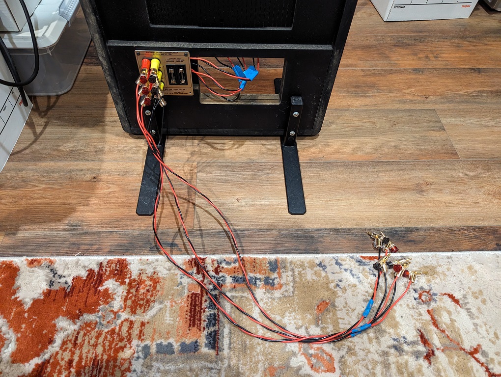

PostPosted: March 6th, 2024, 6:07 pm
Posts: 928
Have the first 1.7 rewired for testing with the locking banana connectors.
