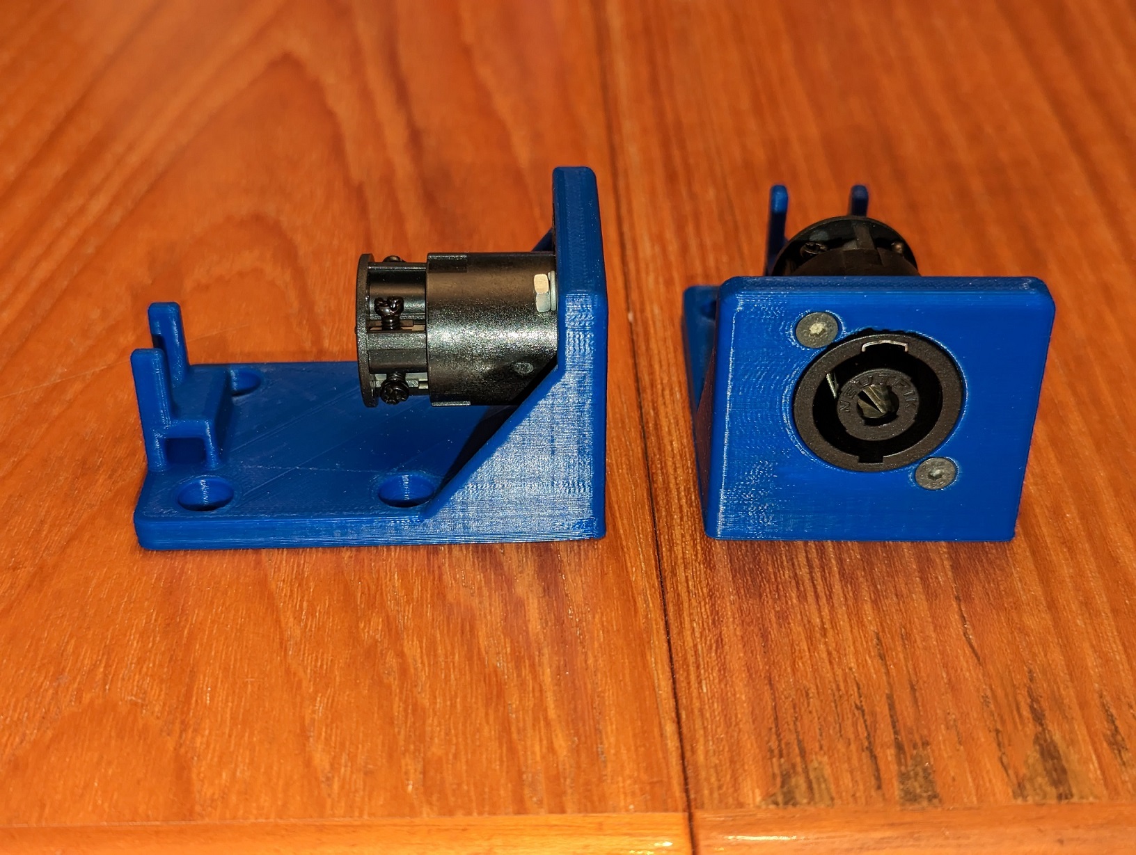

Building up the servo subs to go with the LM10n planars and using Neutrik Speakon 4-pole connectors for the drive and servo sense coils. Needed a way to mount them, so talked to a friend that does CAD and 3D printing. We came up with this idea for a mount that lets you secure the wiring to the mount with a wire tie. I have the now and getting the mounting hardware for install and the 3mmx0.5-12mm hex head screw hardware arrived.
These will go in two 3x12 servo sub module stacks with the LM10n planars. With a 3x12 stack separately mounted behind the planar the top 12in woofer is coaxial to the planar. Then use delay to match up the wavefronts to the listening position.
If someone wants these for a project, just let me know and he will make more. I have 18 of them for my installs in black and blue, so other colors are possible like yellow, red, green etc from the filament catalog.
