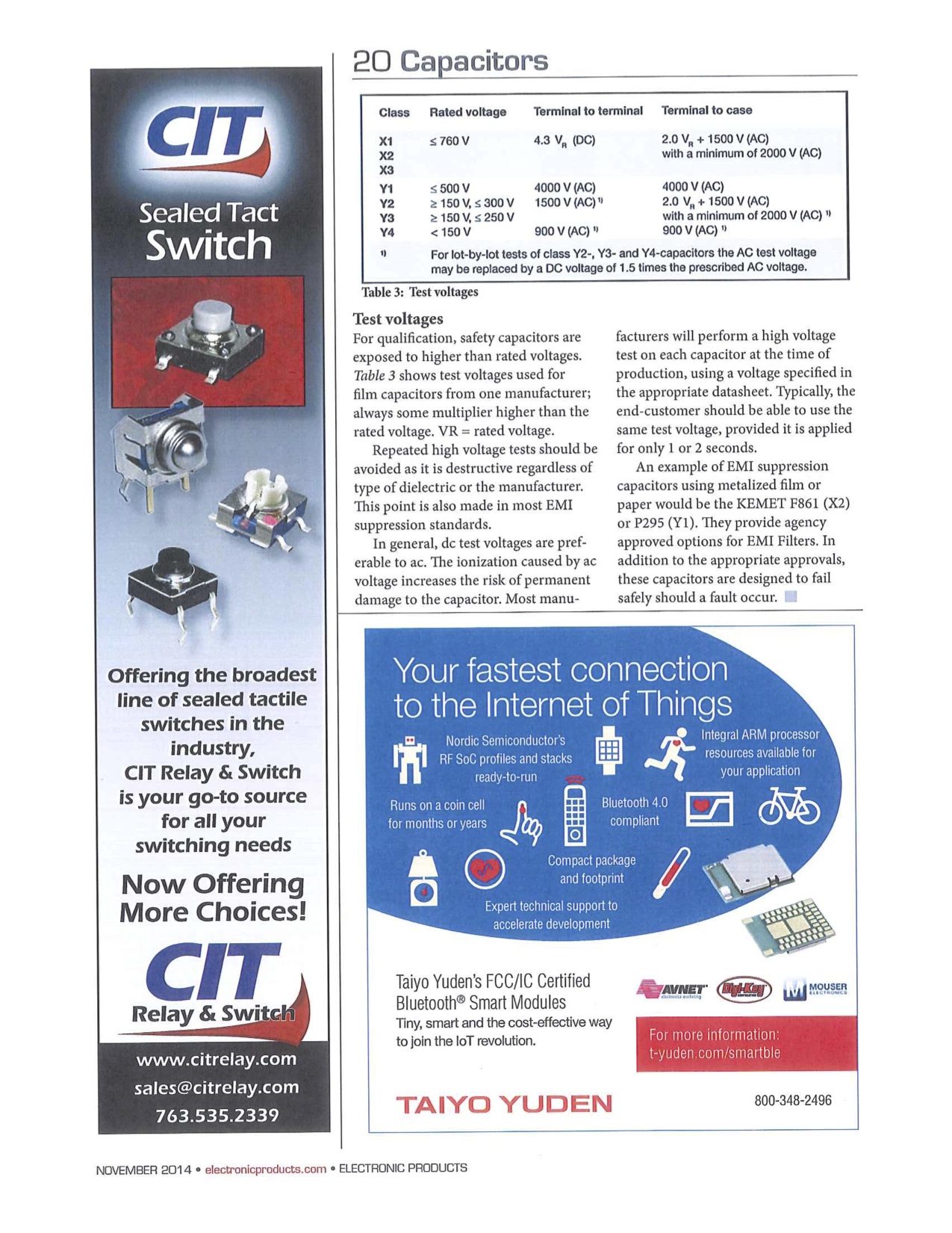

Attached is a discussion of the type of capacitor to use when building an electromagnetic-interference (EMI) filter for a power supply.
It's a reminder not to use just any capacitor in this application because it may create safety issues. These caps are easy to obtain from common venders like Mouser and Digi-Key.

File comment: 1st page of article.
File comment: 2nd (short) page of article.

Great advice. In addition to straight capacitors they are also available with series resistors in the same package to act as snubbers.
