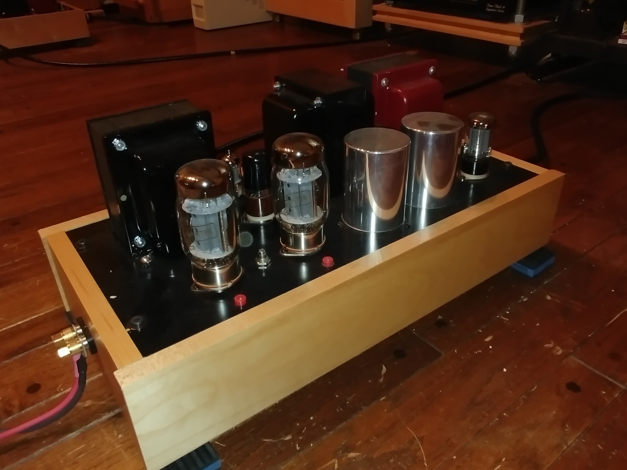

I have delayed posting about this project after a certain amount of embarrassment, since my first attempt of getting this amp working was using a Dynaco Modified Williamson circuit that just did not work for me, despite getting great advice by Grover, Charlie, and others (apologize to the non-credited). However I was able to get a working and nice sounding amp using a modified Mullard topology.
The amp is a Push Pull KT88 using DynaParts A-431 output transformer, an Angela Instruments universal power transformer, and a big honking 10H/300mA Hammond choke on top. Power supply is all motorrun capacitors (you see two 100uF caps poking thru the topplate, there are more underneath). Tube rectified, using a Mullard GZ34. B+ is around 450VDC
The circuit is a modified Eico HF-89 circuit, i.e. Mullard, with a 5751/12AX7 input amplifier, direct coupled to a 6SN7 Schmitt phase splitter with a CCS on the cathode, cap coupled to the KT88 grids. Using fixed bias, with adjustable bias level for both tubes (from underneath the amp), and balance adjustment on the top of the amp, similar to the arrangement on the HK Citation V.
Tube lineup currently is a Genelex Gold Lion (reissue) 12AX7/B759 in the input position. A Brimar 6SN7 (CV1988) for the phase splitter, Genelex Gold Lion (reissue) KT88.
The amp is built on a blank Hammond 5U front panel. Chassis is Birch veneer plywood that I had around, I built these during the early part of the shutdown, so did not want to run to a lumberyard to find nicer wood. It turned out pretty well.
Coupling caps are 0.33uF Miflex KPSU-01 Copper film and oil. Poor man's Dueland. I just ordered (and should be receiving) a quad of the newest silver oil Dueland bypass (0.01uF) caps for bypassing the Miflex. This is an arrangement that Charlie Phelps and Jim Gerfin found to work great, though both of them have the Dueland coupling caps in their amps.
I have been listening to them for several weeks, and it is nice to have the power reserve on my Elsinore speakers. The PP amp has great control at the bottom, and sounds uncolored through the entire range. Reproduces a nice 3D soundstage that is expansive. Nice detail and timbre. Very happy with the results.

(Thumbs up emoji) Nicely done David. Great use of the time. Looking forward to having a listen...soon.:-)

Nice work, as always David. :thumbup: :thumbup: :thumbup:
BTW, the rest of us are quite often embarrassed by the quality of your workmanship in comparison to our own, so don't feel bad about not being able to make someone else's Frankenstein Feedback circuit achieve stability.

Very nice! There's more than one way to skin a cat! :-) Those Miflex caps are quite nice.

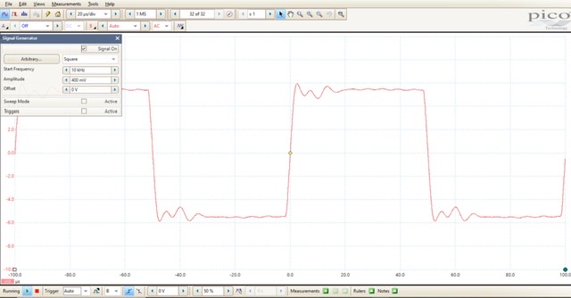

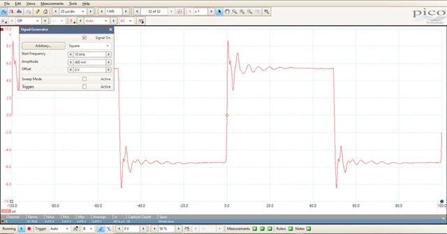

David, as an update on this, I just built the same thing, only using the Acro TO-330 outputs and EL34s. I will say that that bias circuit is tricky. I had to fiddle with it quite a bit to get the output tubes stabilized at the right operating current, about 65mA each. And if it's any comfort, this "stable" Williamson is anything but! Of course, the Acros are notorious for HF instability, whereas the Dynacos are probably a lot calmer. Even so, at first measurement I couldn't attach a probe to the input without the thing going haywire. I modified it with my all-purpose, rather aggressive HF rolloff filter at the input (1200pF + 820) and it was stable with .22uF across the 8 ohm load. Here are some pics, first the stock circuit at 10kHz, then the stabilized version, and a frequency plot of the stable version. You can see it's still "singing the mass" out to 100kHz, but it's flat to 20kHz. The red line represents the phase shifts.

 Post subject: Re: PP KT88 Amps
PostPosted: September 6th, 2020, 3:41 pm
with an additional feedback loop and a weird resistor bypassing the coupling cap to each output tube
With that resistor bypassing the coupling cap, are you sure you actually had a negative voltage on the grid?
Excellent question! Me thinks the builder mistook a grid stopping resistor as a resistor installed across the coupling cap. That would place +DC on the power tube's grid. Not good. :o
The tube would pull full current until self-destruction. :shock: Either fixed bias on the power tube grid of say -50-vdc (a S.W.A.G.) or cathode bias.
But under no circumstances bypass the inter-stage coupling cap.
