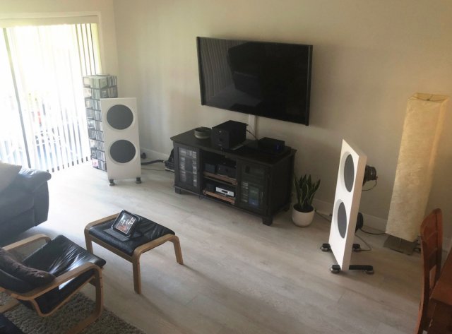

I'll throw my 2 cents in. I'd put the network back to factory to start, and work on positioning if that's possible. The speakers appear to be too close to the front wall and the chair too close to the speakers. Not to generalize but OB speakers I've heard like being out in the room, perhaps with diffraction behind them to give you later arrival of the rear wave. If that's not possible, try separating them much wider and turning them in so you're on axis at the chair. Much wider. That may also get you better dispersion of the rear wave. The setup I heard at CAF (maybe M3?) had the speakers setup on the diagonal across a corner, likely because they couldn't get them to image well in the normal arrangement.
I don't know if they're designed to sit below the tweeter, but that appears to be the case in your picture? Any less of a problem standing? Again, possibly an indication the chair is too close or too low?
Attached a picture of the wide on axis arrangement.

Absolutely right. To get a good audio performance a good room is a must. Not saying Paul's room has problems or anything.
Also, IMO OBs should be at least 8-10ft from the rear walls. But then Paul was using Magnepans which are OBs also. May be too much bass energy firing towards the rear wall from the twin woofers in the new system might be contributing to the problems.

Speakers are almost four feet out, two feet from side walls.
Don’t be fooled but wide angle lens.
Speakers were set up as designers recommendations for the size of my room.
I have adjusted a couple of inches each way to try to get the best sound.

Subs look too close to the woofers.
