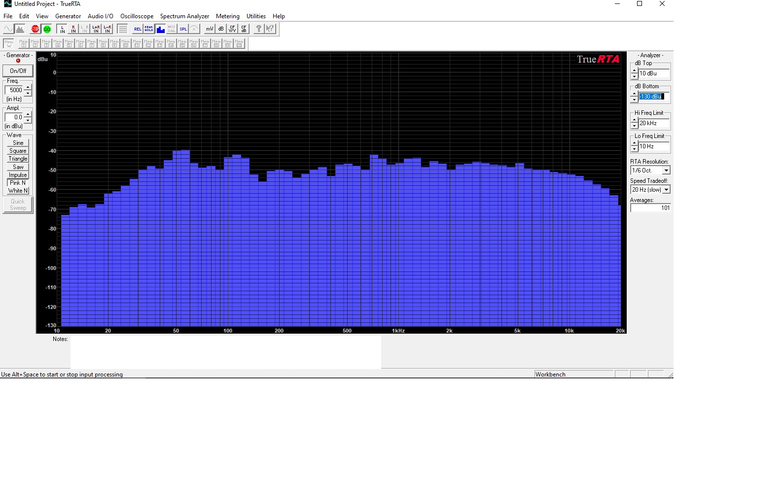

If you look at the full range graph it is pretty flat

It appears that you have a -4-db depression in the lower mids/upper bass from 150-Hz. to approx. 400-hz. and your treble is down -14-db at about 18-kHz. with the roll-off starting at about 6-kHz.
Then of course there is the lower bass roll-off as would be expected with an open-back dipole.
Did you experience that response characteristic with your Magnepans?
