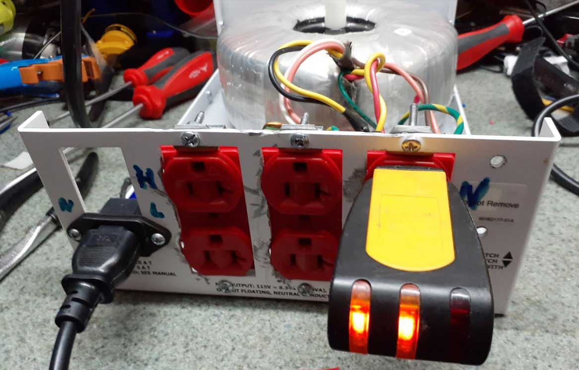

I finished the rebuild with ground isolated sockets. I made sure of polarity integrity throughout. I also separated the secondary's with one socket on one secondary for 3.5A AC and the other secondary supplying two sockets just in case paralleling the secondary was the problem.
I still have the open ground probably because I did not follow Stu's schematic. I just want to know if I understand it correctly. The schematic shows the neutrals and grounds on the secondary side are bonded to house ground.
Since all grounds are bonded together at the chassis, then all I have to do is connect the secondary neutral to the chassis.

finally

ok as I was putting the iso back in I noticed this:
so the original unit was wired without the ground floating on the output side
and the unit probably would have shown an open ground.
confusion again
its dead quiet, probably better than it has ever been
