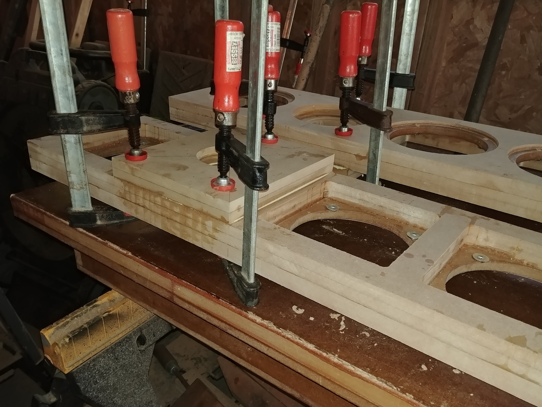

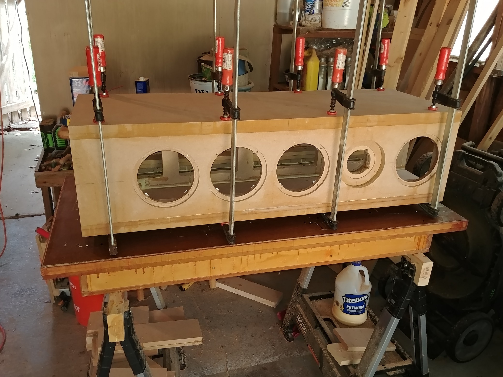

Construction progressing nicely...
File comment: Another view
File comment: Partial Assembly
File comment: Assembled baffle

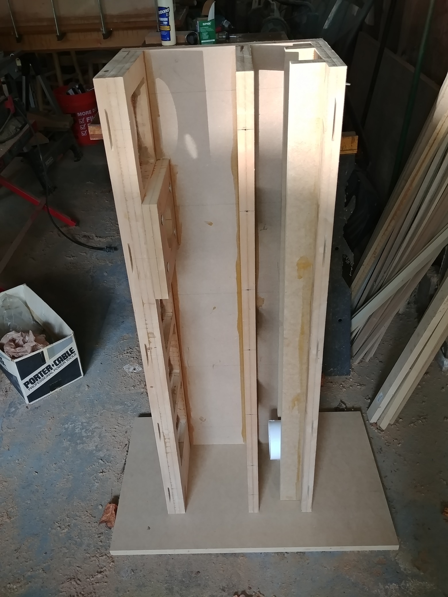

Still more...
These are getting pretty heavy to move about. Currently, the driver holes are good handles to lift the cabinets, but I suspect the final assembly of these speakers may be in situ after finishing is complete. I expect to be starting to patch and sand these down later this week (or by the next weekend) to prep them for painting. I still have some router work to do (chamfer the edges). Also, still debating whether to veneer the top and sides, I have such a nice flat surface. Really depends how well the top and bottom blends into the side panels.
File comment: Another view of assembly
File comment: All but the top and bottom

Agree, never enough clamps. I was eyeing more Besseys on my last trip to Home Despot. However figured if I staged my glue-ups right, I would get by with the number I had. Using biscuit joinery helps, since they most of the alignment, and once you hammer the panel down, just need the clamps to provide clamping force, not holding the work in place. I hate using screws in MDF, they either split out the work (even after drilling holes), or don't hold well, so planning on using dowels for alignment of top and bottom during glue up. Also made some nifty clamp extenders, since none of my clamps are long enough for the height of the speaker (45" tall).
