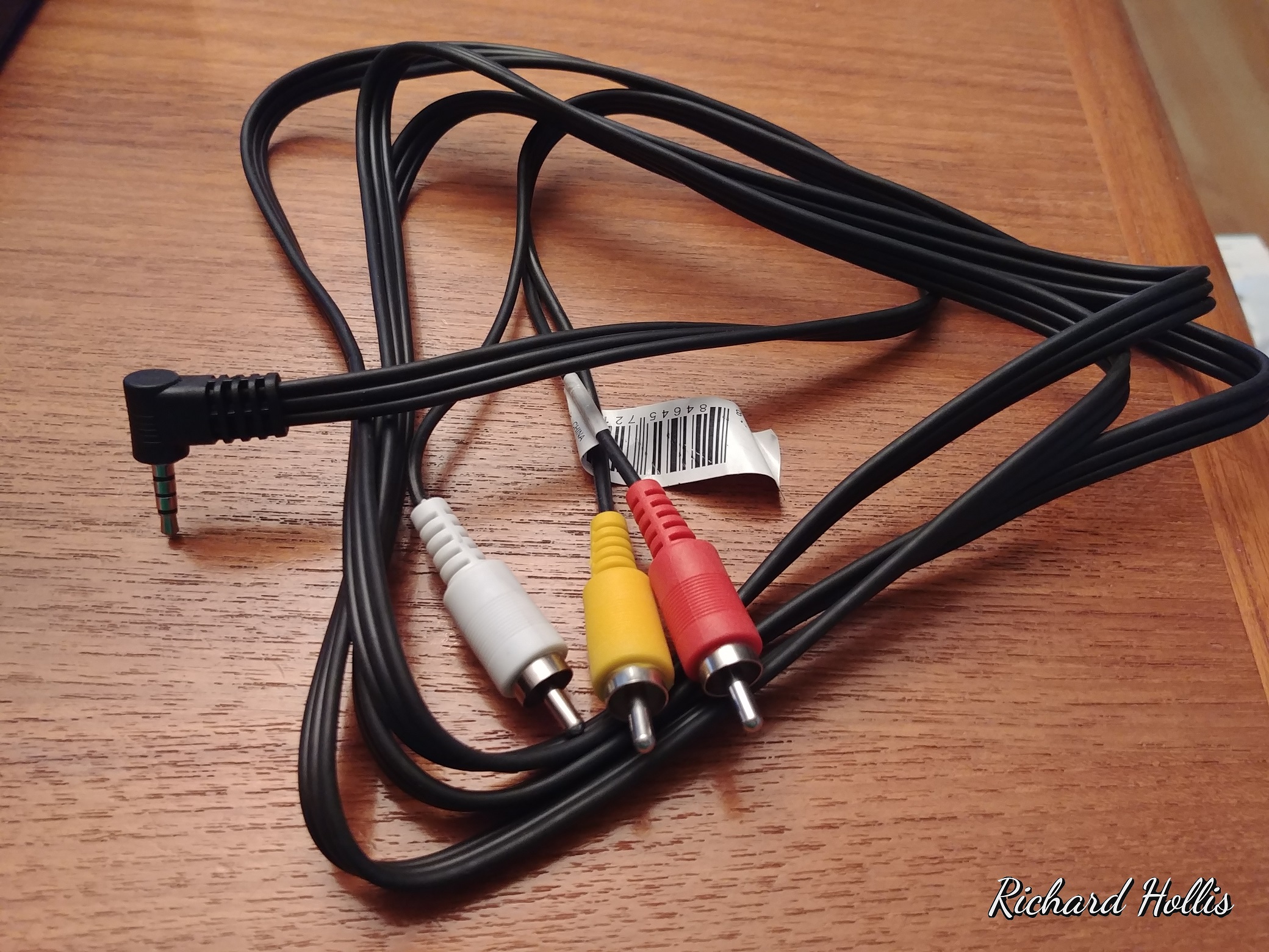

Cable to connect the RPi4B DAC to the system for measurements. TRRS to RCA cable.
