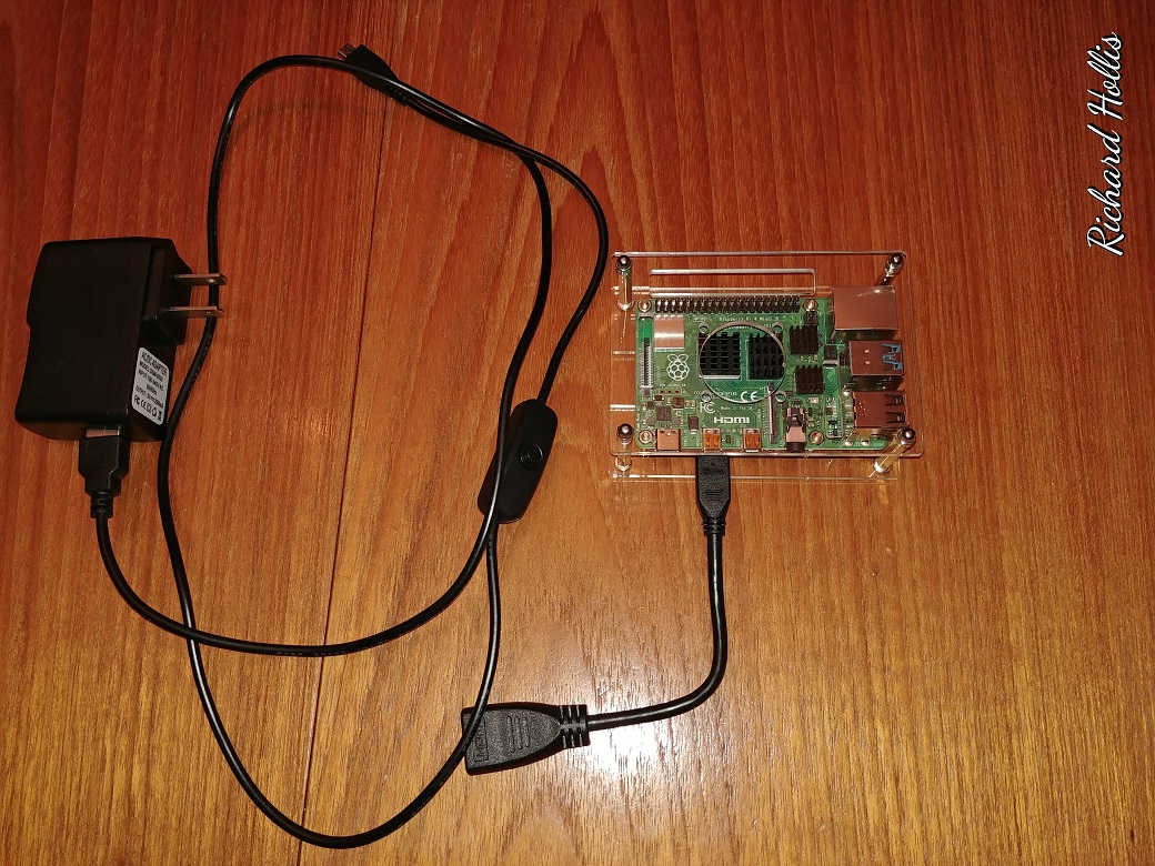

After trying out the RPi3B+ running Raspbian Stretch, had problems running Room EQ Wizard for room measurements. I bought a RPi4B to test and loaded Raspbian Buster OS. Now REW runs correctly up to 24bit/192KHz for measurements. Appears to have been an OS problem as when I reloaded the RPi3B+ with Buster OS it also works.
Been using the RTA function with the noise generator for room measurements with very good results.
About ready to integrate the 7" RPi display to make the entire system small and put it with the system for use so I can be close to the controls on the servo sub amps to make adjustments in realtime.
Have one of the Dayton Audio USB mics to test with it and see if it works. If not, will go back to using the DSP processor instead as I do on the PC.
Truly one of the things I do not see discussed much, but makes a huge difference for the better for sound quality.
YMMV
