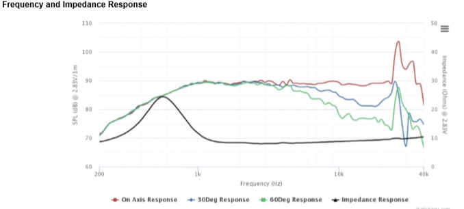

PostPosted: May 28th, 2020, 9:44 am

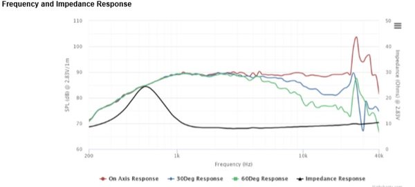

Tweeter data sheet response curve:

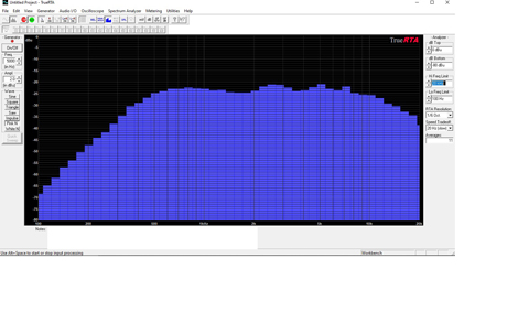

my measurement: only showing 100Hz on up

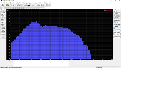

The two 15inch woofers:

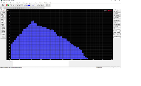

Bottom

It's interesting in that you have an issue with tweeter dominance in a bad way and yet the in-room response shows a "soft" roll-off.
Because of the attachment resolution I can't read the scales, but it appears that you have a depressed lower mid-range as well.
Did you try (carefully) to run the speakers without the 33-ufd capacitor to evaluate the capacitor's effect on sound quality?

If. I understand you correctly if I low pass at 6k. Dose this mean the drop off is above 6k, then there will be no highs
exactly.
The idea is to evaluate if the tweeter is any good. If you are happy with the tweeter's performance within a Decade, you can entertain the idea of adding a super tweeter above 6kHz. if you are still not happy with the tweeter, well you know the answer.

PostPosted: May 28th, 2020, 10:40 am
No I have not run the speakers with out the 33uf yet.
still waiting to hear what the designer has to say.

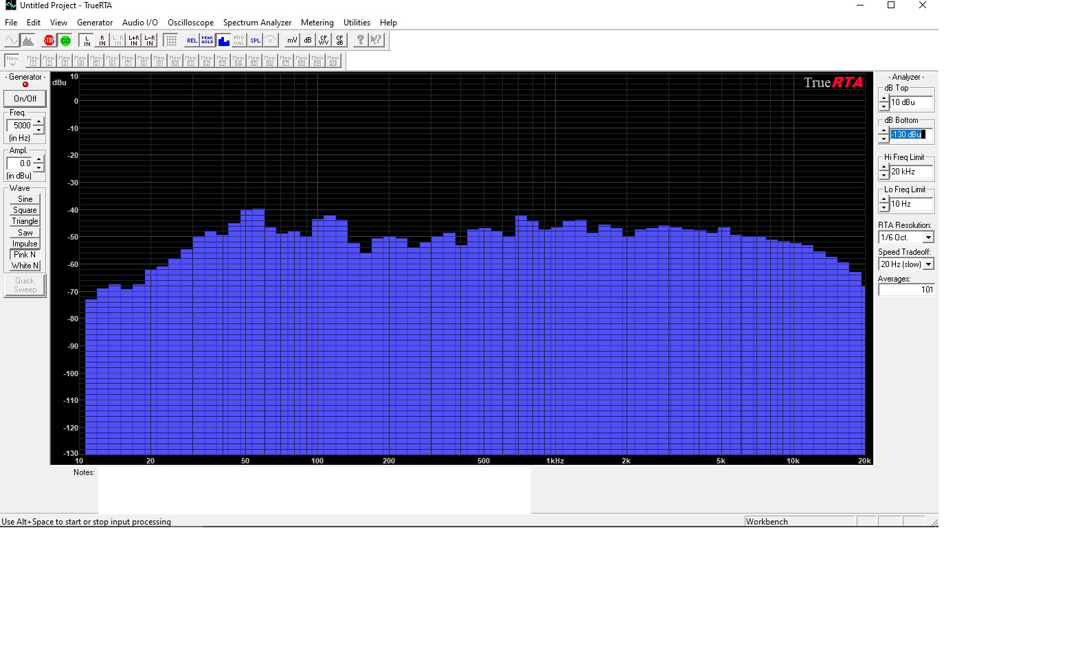

If you look at the full range graph it is pretty flat

It appears that you have a -4-db depression in the lower mids/upper bass from 150-Hz. to approx. 400-hz. and your treble is down -14-db at about 18-kHz. with the roll-off starting at about 6-kHz.
Then of course there is the lower bass roll-off as would be expected with an open-back dipole.
Did you experience that response characteristic with your Magnepans?
