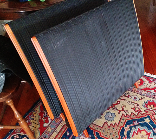

PostPosted: April 17th, 2017, 4:29 pm
with more than a dozen unfinished
Quad 57 in the house Serial numbers show they are from 1981

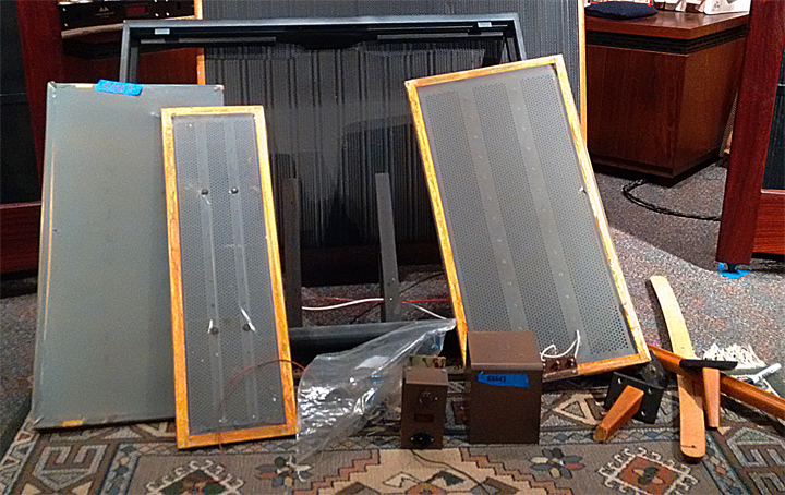

PostPosted: April 17th, 2017, 4:33 pm
actually heard them play (sort of)
took one apart to see what the hey
not much there, should be fun, time to get educated

PostPosted: April 17th, 2017, 8:19 pm
The Quads are Electrostatic.
My maggy's llla's are planers are sitting in the background
The Quads Stators are charged at 3 to 5k vdc depending who you are reading.
Any way I will be replacing the Diode board in the power supply, the caps in the xover.
Removing the dust covers, felt batting and eventually building a stiffer hardwood frame.
I like the look of the metal grills but these are banged up some and will been some TLC to get presentable

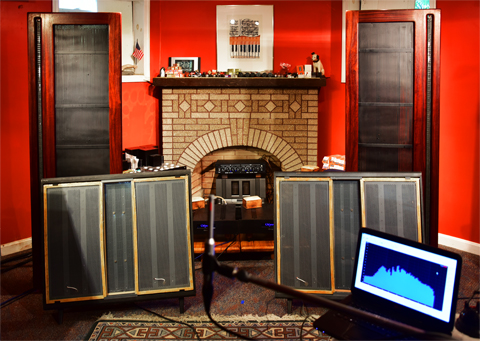

PostPosted: August 5th, 2017, 12:29 pm
Almost four months later and project is almost finished
They are playing nicely. This was my first try at there electrostatics.
I made many mistakes along the way and had to go back and order bits and pieces and it just took time
replacing the dust covers on the panels was troublesome mainly from just not having a suitable clean work space.

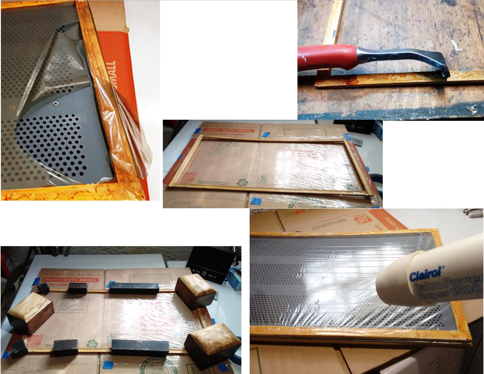

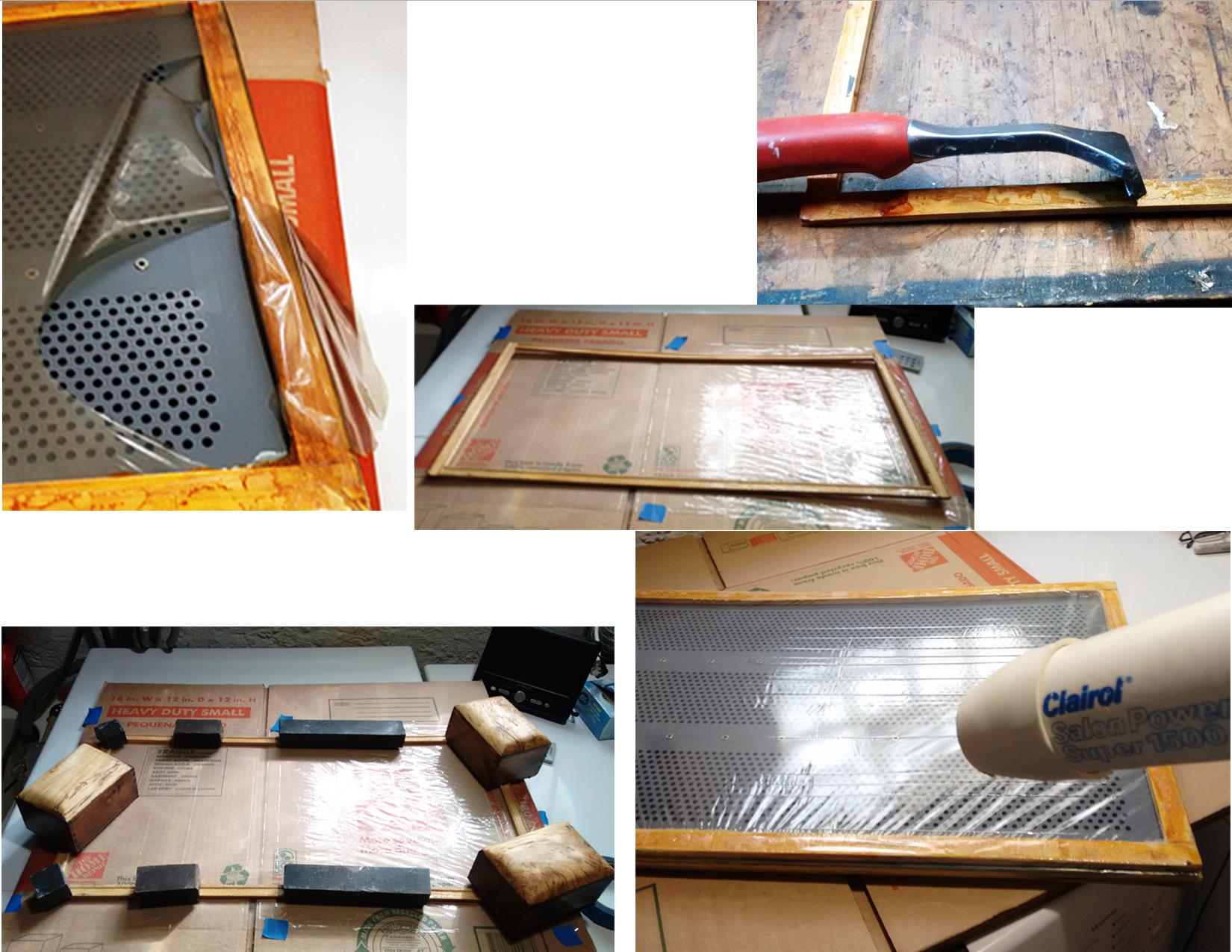

PostPosted: August 5th, 2017, 4:42 pm
The dust covers were a pain I had I had four bass panel to redo, two dustcovers each.
the frames were fragile, needed regluing the corners after scraping and sanding I used 3m FastBond 30-NF (same glue I used to rebuild Maggy panels)
to glue the heat shrink film to the frames. The frames are held in place on each side of the bass panel with just plain 2 inch wide packing tape.
the hard part is handling the completed panels without damaging the film while reassembling the speakers.
