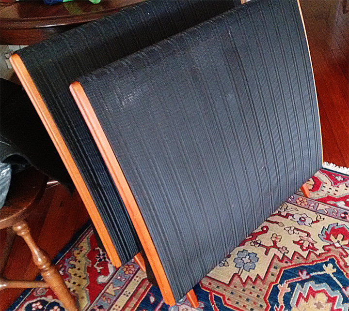

with more than a dozen unfinished
Quad 57 in the house Serial numbers show they are from 1981
PostPosted: April 17th, 2017, 4:33 pm
actually heard them play (sort of)
took one apart to see what the hey
not much there, should be fun, time to get educated

PostPosted: April 17th, 2017, 8:19 pm
The Quads are Electrostatic.
My maggy's llla's are planers are sitting in the background
The Quads Stators are charged at 3 to 5k vdc depending who you are reading.
Any way I will be replacing the Diode board in the power supply, the caps in the xover.
Removing the dust covers, felt batting and eventually building a stiffer hardwood frame.
I like the look of the metal grills but these are banged up some and will been some TLC to get presentable
