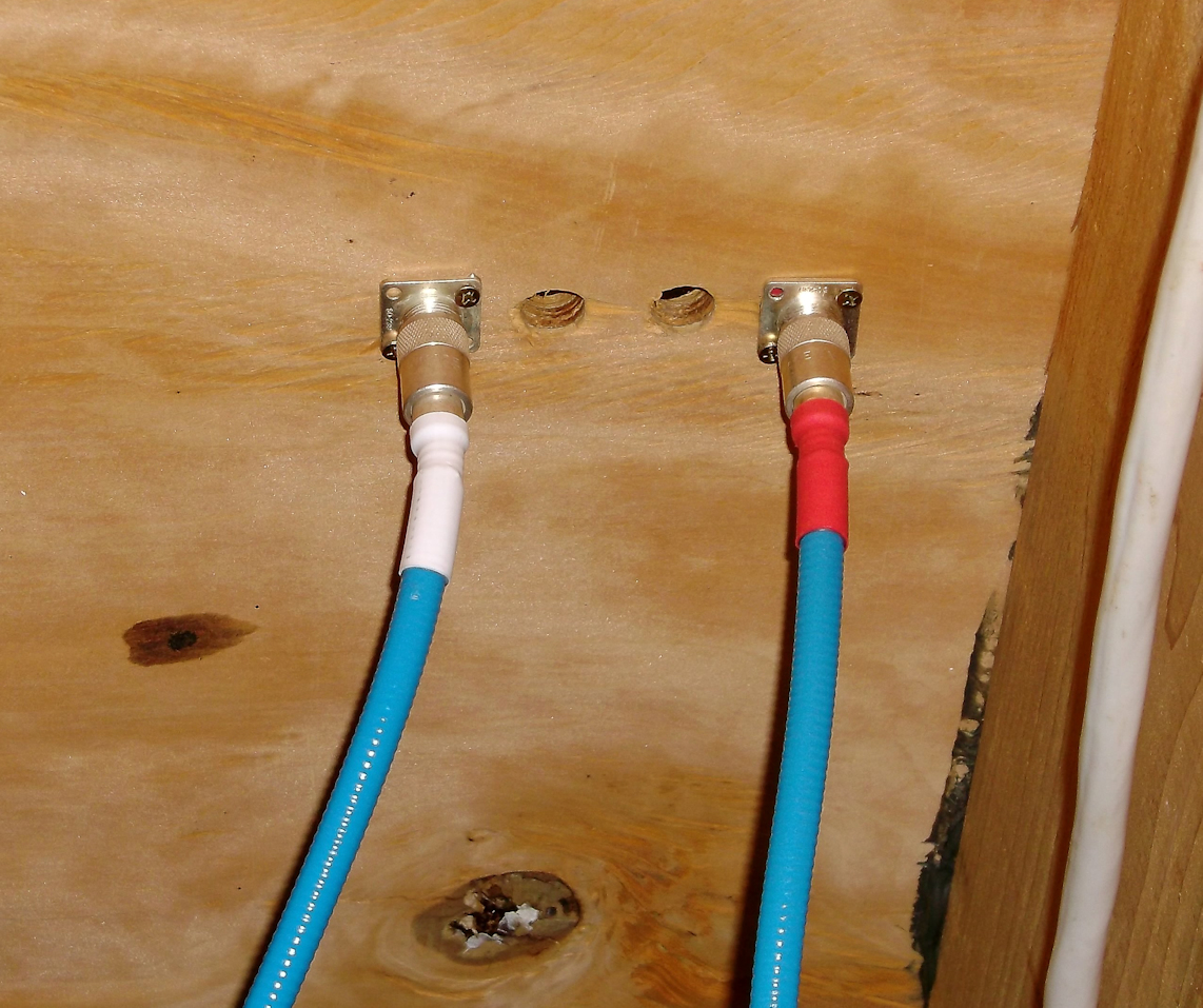

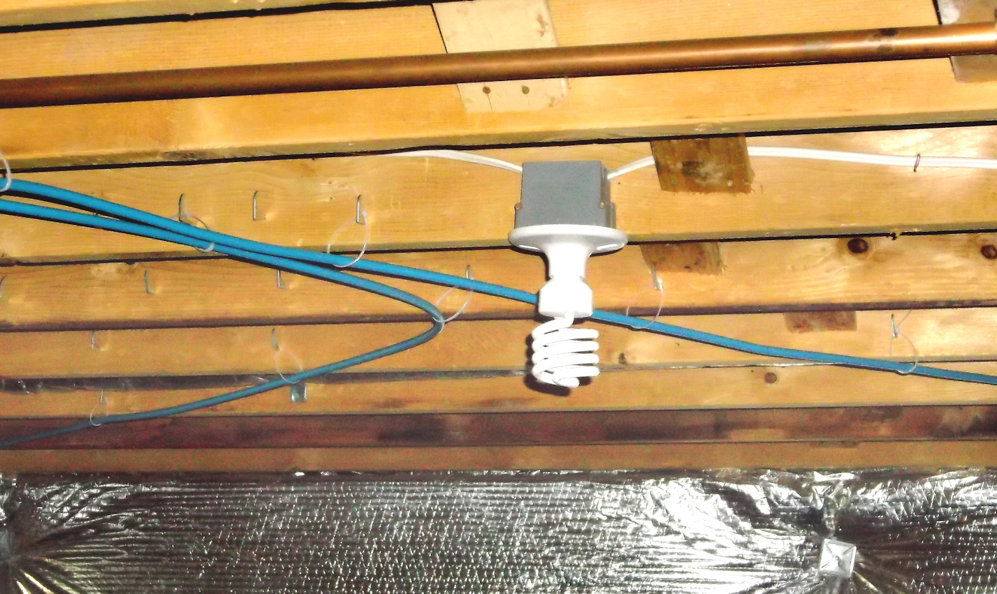

I got lucky and nabbed a 100' bundle at a ham fest some 15 years ago and it just sat in my basement. I was using a cable I obtained from the Boeing Warehouse in Everett, Washington that I could not part with for some 20 years. I have tried many "audio" cables and the Boeing stuff was always the cable that served the music in a good way. Then I looked the Heliax through "new" eyes and did a temporary trial with alligator clips. HOLY CRAP!! It wasn't even a contest! So I terminated a pair -- and as Paul Ellicott said -- they are special. A buddy of mine has had the same experience. :thumbup:
I terminated them with male Silver PL-259 connectors and attached female PL-259 connectors to the floor of my living room at the amplifier and speaker ends. I run the cable under the floor. What can I say? I like things neat. The female is terminated with 8-inch twisted pig-tales up through the floor to the amps. and speakers.
So -- you could say that my house is now actually part of my audio system. :crazy:
Working with Heliax is another pain-in-the-ass. A thermal stripper, a plumber's copper-tubing cutter, together with a 250-watt vintage soldering iron gets the job done. You will not be able to solder with a soldering gun. You need some serious Btu's to overcome the heat sinking abilities of the copper-tubing shield and silver connectors. The big-ass iron will pump plenty of heat for good solder flow.

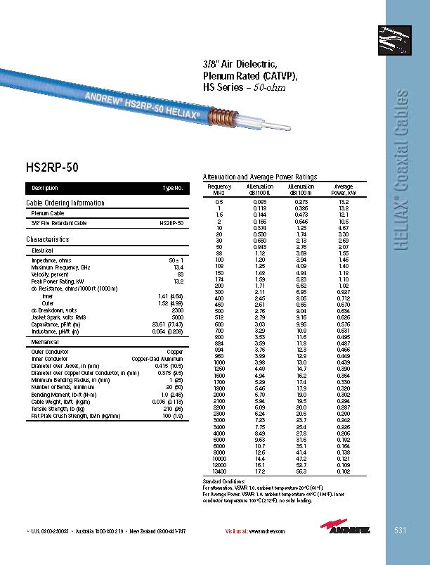

The mental picture regarding aluminum was my problem as well. I kind of had buyer's remorse when I bought it at a Hamfest so I never even tried it until recently. My epiphany was the result of a conversation Tom P. and I had at Rosco's a while back and we got into a discussion about materials. Taken out of context -- Tom remarked that aluminum is not magnetic like ferrous metals after my comment that aluminum makes for a good Faraday shield. Then it dawned on me -- had I been technically asleep for a couple of decades -- WTF?!! Aluminum is almost as good a conductor as copper and Andrew surely had some solid reasons for manufacturing a micro-wave-capable cable using copper-clad aluminum for the center conductor. Speed and power handling was the reason -- or so I suppose. Looking at the data sheet -- the stuff is rated at 13-kW. YIKES! My Careys top out at 50-watts and my Altecs barely use that. It is also extremely low-loss cable at extreme frequencies and lengths. And for one example -- mine -- at 25-feet amplifier to speaker the D.C. resistance of my run is only 0.03525-ohms. Almost like no cable at all. At 500-kHz. 100-feet of the Heliax attenuates only 0.083-db.
When all is said and done -- now that I have crunched the numbers -- I can see why it has done such a remarkable job with mere audio. It passes on the edges of the complex wave-forms (aka. resolution) because of its extremely wide bandwidth. Same goes for the Phaseflex.
