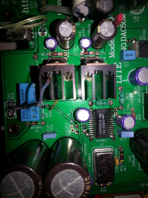

Roscoe, HAL, if I understand correctly, the CS8414 serves to change the S/PDIF (in my case the balanced version) to the I2S protocol?
The DAC chips are BB PCM63. There are two other on board chips.

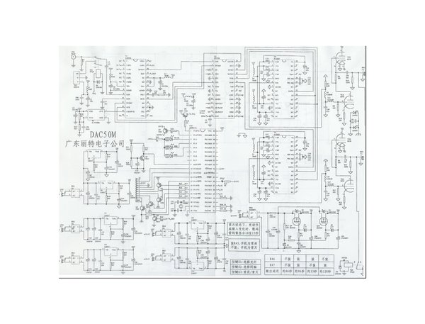

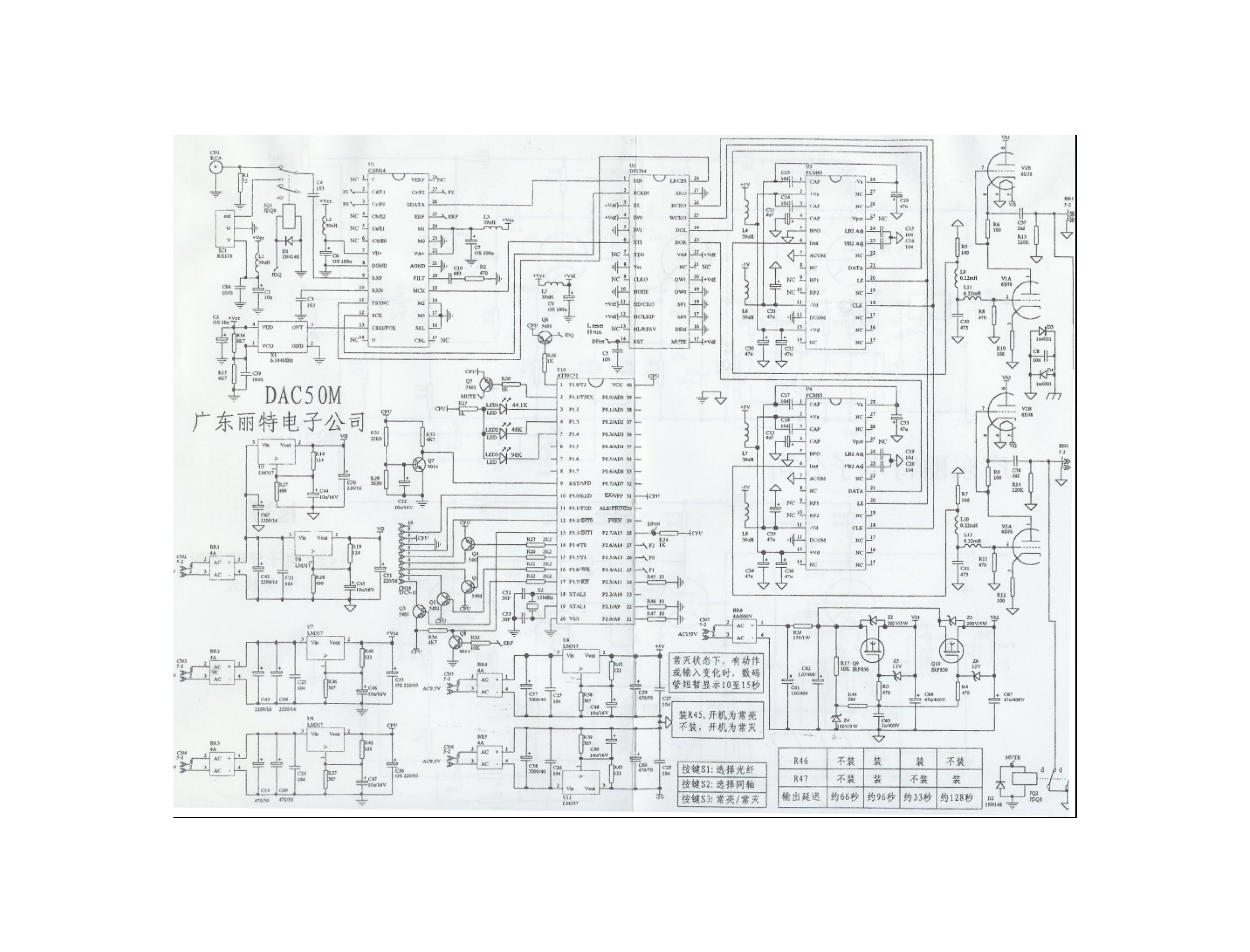

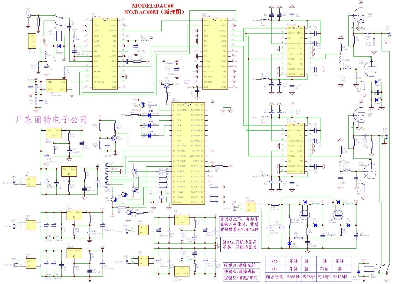

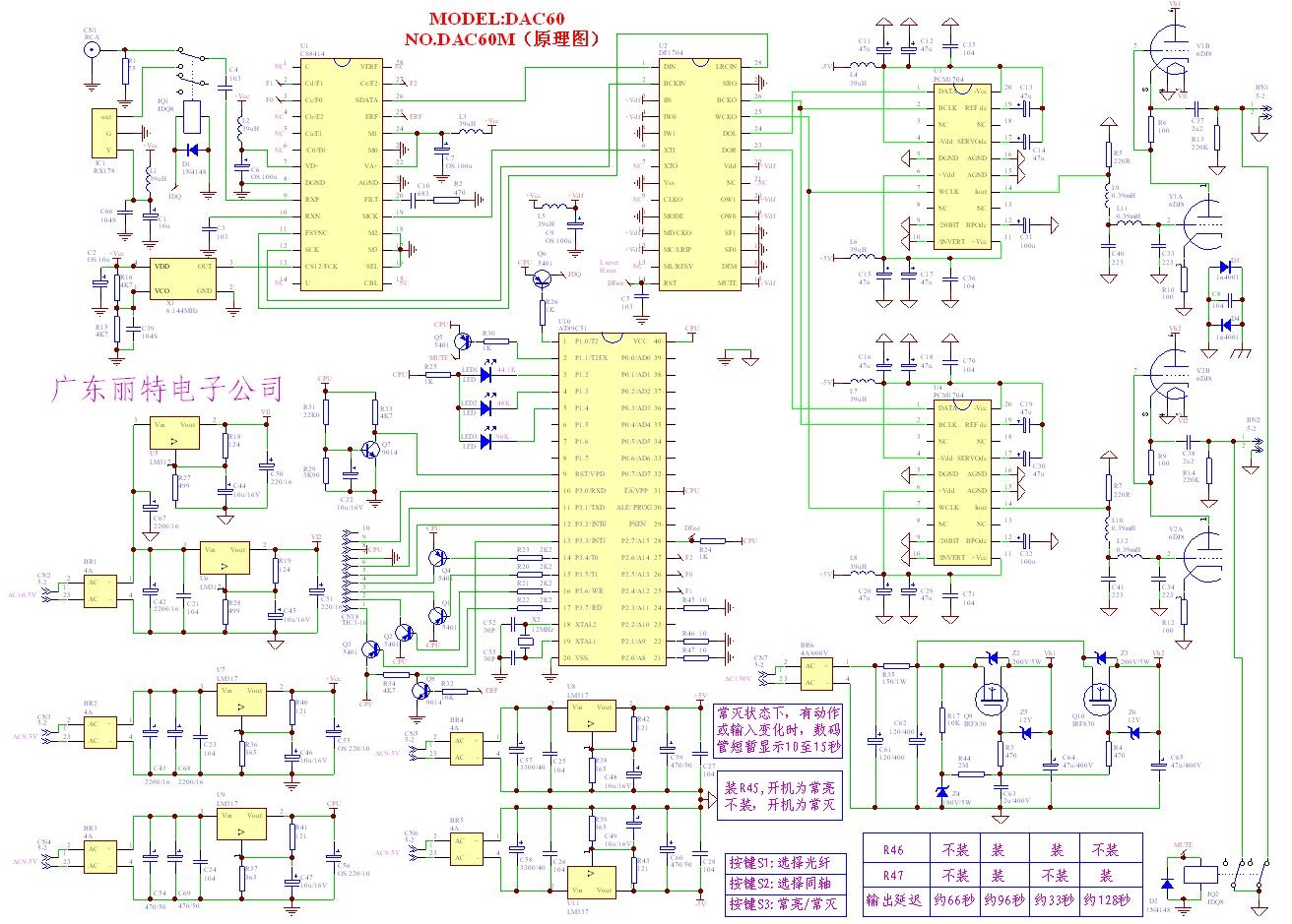

I don't have a super clear schematic. The DAC 60 is similar to my DAC 50, may be more legible.

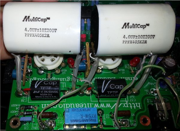

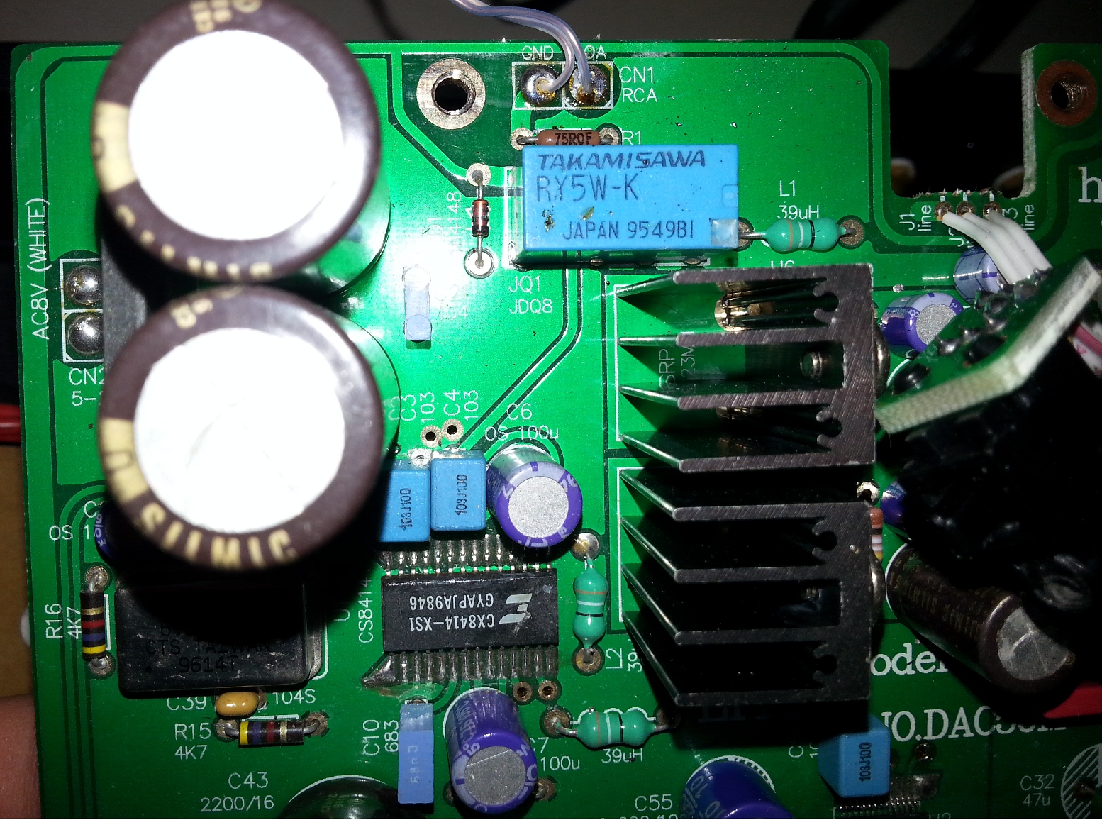

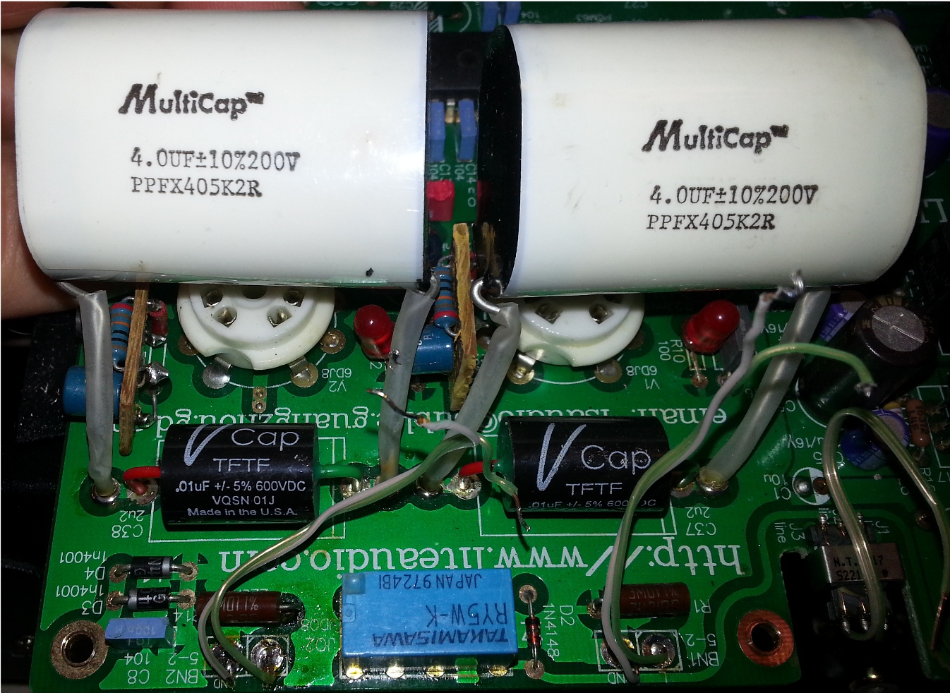

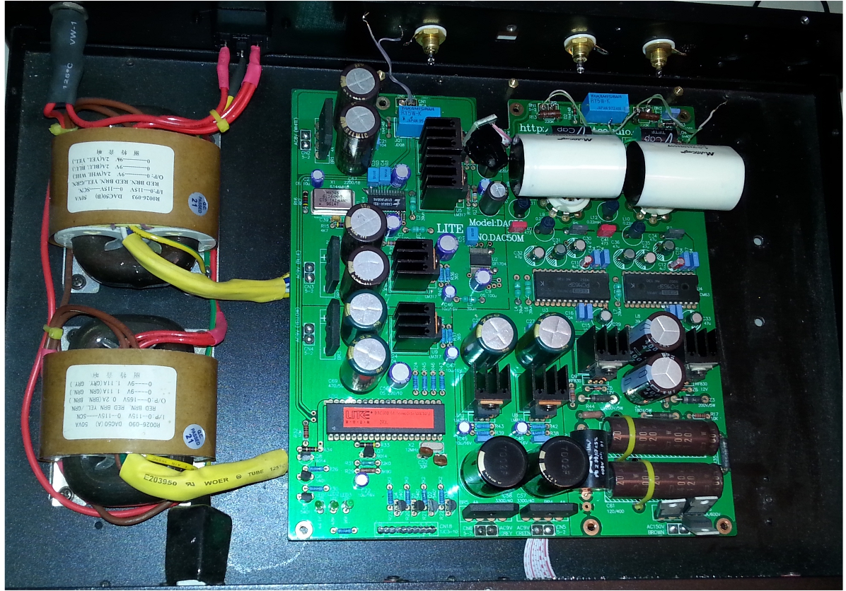

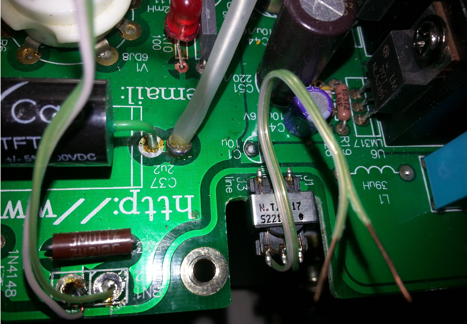

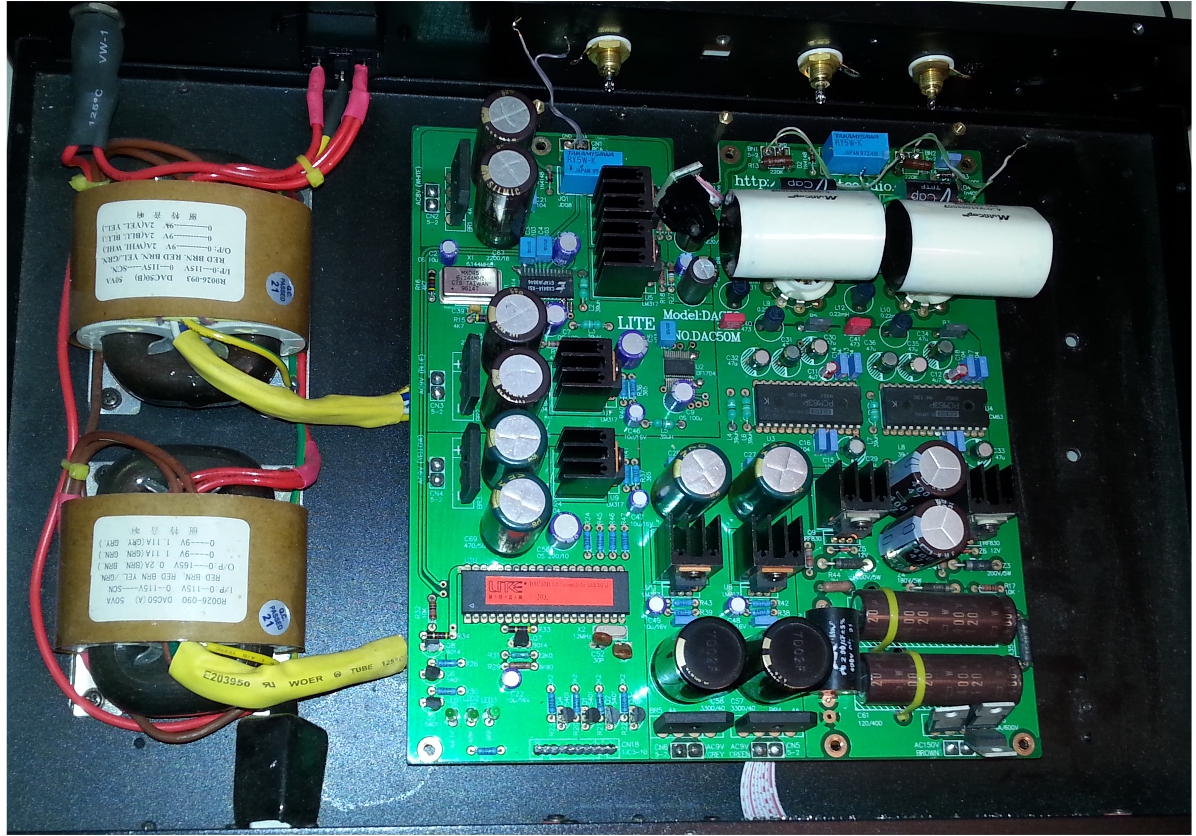

Pictures are attached from when I replaced the Toslink input with a transformer, per Crystal's data sheet on the chip, to allow balanced input. Attaching both schematics. Will have to do multiple posts due to file attachment limits.
Does this help?
PostPosted: May 26th, 2016, 8:17 am
This may be a bit more legible. But not exactly the same DAC. VERY close.

As Roscoe points out, the CS8414 would need to be removed from the DAC pc board and the I2S Bus lines used with any of the USB to I2S Bus conversion systems.
Here is a link to the datasheet if needed to see the I2S Bus pins.
http://www.futurlec.com/Others/CS8414.shtml
I have a DAC60 and it has DF1704/PCM1704 DAC's. Had mine moded and still works.

Looking at the DF1704 datasheet ( http://www.ti.com/lit/ds/symlink/df1704.pdf ), it looks like you might have issues with the XTI line on the DF1704, which is currently fed from the CS8414. Looks from the datasheet that the DF1704 can operate on it's own internal clock, but not at 96K. You'd need to change one or more control pins on the 1704 to make it run on it's own clock...
PostPosted: May 26th, 2016, 9:15 am
Okay, the bulb is very dim, but it's starting to glow.
The I2S lines are pins 11, 12, 19 and 26. It appears that everything prior to that is associated with the 8414 and can safely be removed.
Ideally, I'd like to leave the S/PDIF and AES/EBU inputs in place and be able to switch between them and USB.
Can I simply cut traces, insert a switch or switch controlled reed relays, and add the USB/I2S interface?
It seems that several firms offer boards for this application, the Amanero one HAL linked to as well as Sonore and JL Sounds. The Sonore is a lot more money, but would be worth it if there is a big performance improvement.
