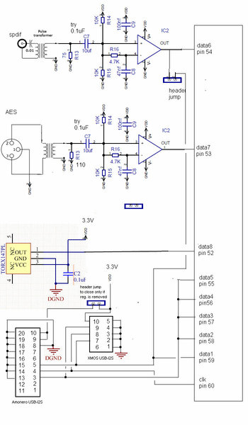

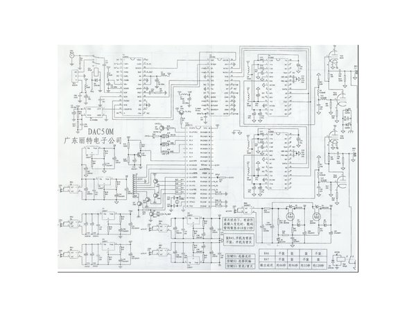

With the occasional addition of the Behringer DCX2496 to my system, I want to change to a balanced digital signal transmission format. The Behringer is still for developmental purposes, not intended to be in the system long term. But it does have a balanced digital input, so I want to take advantage of this by placing my Monarchy Digital Interface Processor (DIP, a re-clocking device) close to the music server, this providing the AES/EBU output, which will travel 40' or so to the DAC device.
When the Behringer is in the system, the AES/EBU termination is into the DCX2496. When it is NOT in the system, the balanced signal will terminate into my DAC, a China Lite DAC 50.
The Lite DAC 50 does not have a balanced input. I KNOW I can use an external balun. I don't want to. I would rather add an XLR jack if I can.
It looks like I would need a selector switch (SPDT), jack, bit of wire, a 110R resistor and a "pulse transformer", whatever that is.
I am attaching pictures of my schematic (sorry for fuzzy, but you can see the input in the upper left, simple RCA with a 75R load) and the alternate input I propose (minus the op-amps).
Will this work well?
Where would I find a quality "pulse transformer"?
Thanks from a digital moron!

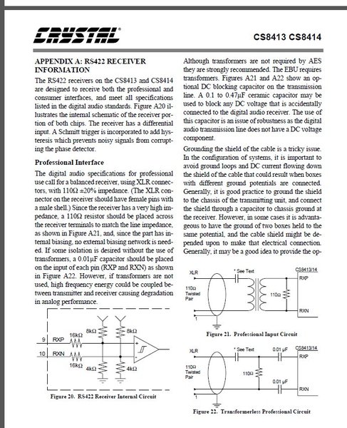

Okay, parts ordered: Newava S22133 transformer, XLR jack and cable ends. Will install per the receiver chip manufacturer's recommendations. Cirrus CS8414.

I added a balanced input to my Lite DAC 50. I removed the optical input, did a little rewiring and used a Newava 1:1 transformer. Added an XLR jack and used the optical selector switch to choose between balanced and unbalanced inputs. Made a short cable using Tom's special Belden 110 ohm cable. DEFINITE improvement in sound!
Was cheap to do, not very time consuming, and worth
