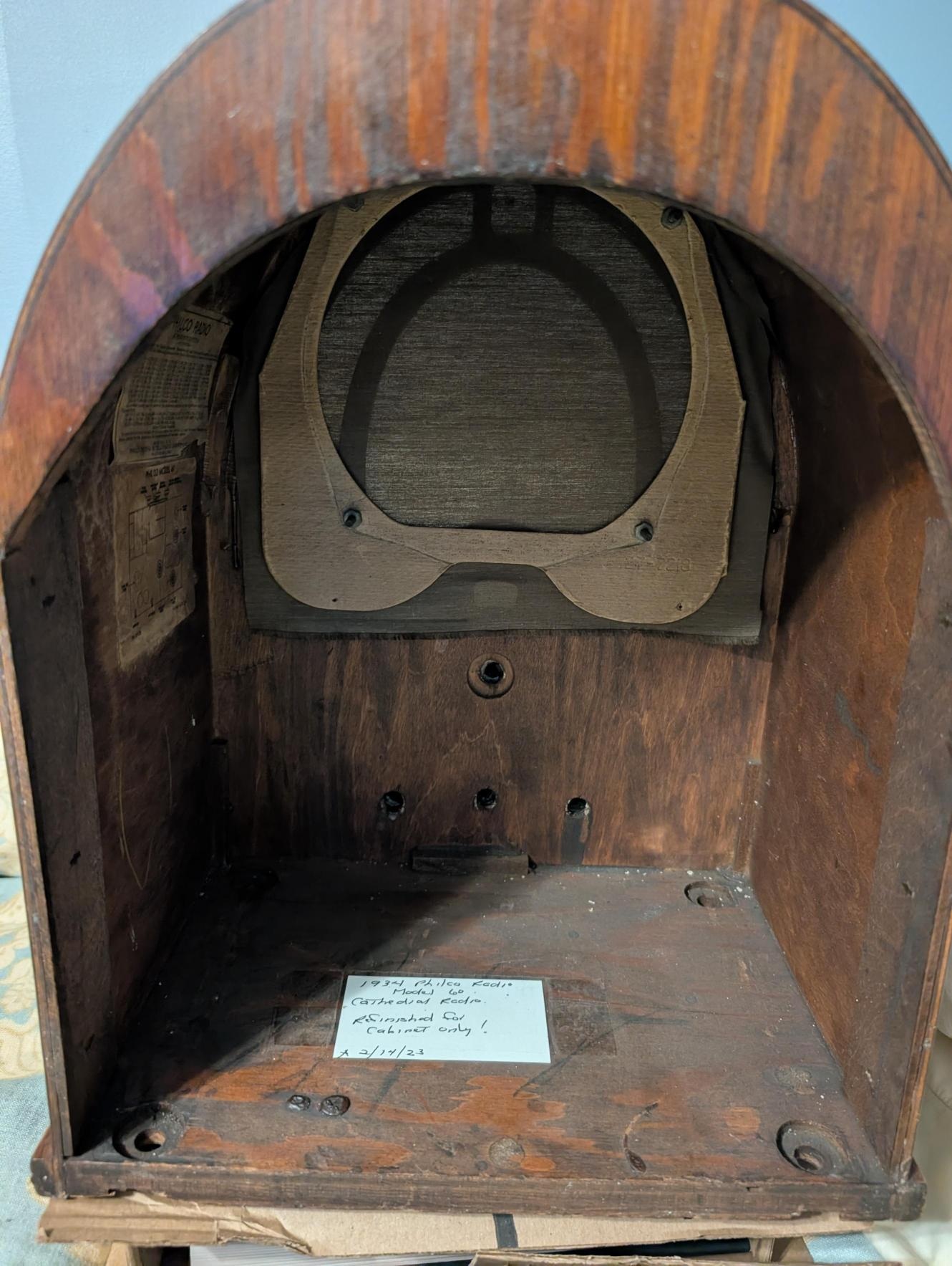

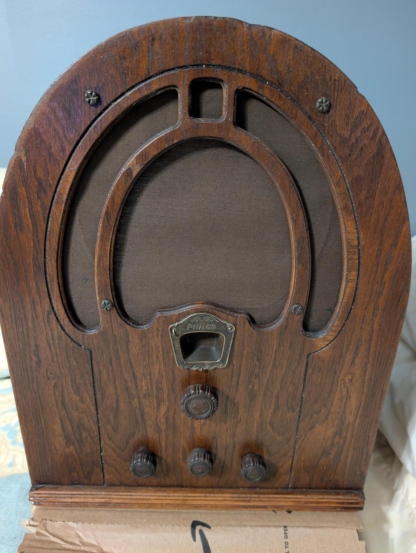

I believe the challenge is finding a way of being able to deal with FM/AM tuning, volume control, source selection and display in the digital age. From what I see, avaialble tuner modules are almost entirely digital, controlled via toggle switches and/or buttons, or if analog, use on-board pots/variable capacitors that would not align with the knob positions on the radio case. Many tuner modules come with a remote control, but you need to have a display to see tuning info and volume, otherwise you cannot see what you are doing. You would need to modify/alter the radio case to accommodate a digital display. This may involve desoldering the display from the digital FM module, install on a new board and use a ribbon jumper cable back to the FM tuner board to the removed display connections. That would be alot of delicate soldering work. You would also need to provide an IR sensor at the front of the case for the remote control. As far as an amplifier, you can use an inexpensive Class D amp to drive the speaker you select to match the mounting interface in the radio case. This is actually the easy part, except of course for volume control if the tuner module control is inadequate.
This is quite a project that will require some research, improvisation, and technical ability. You need to solve the interface issues with the specific parts you are considering using.
