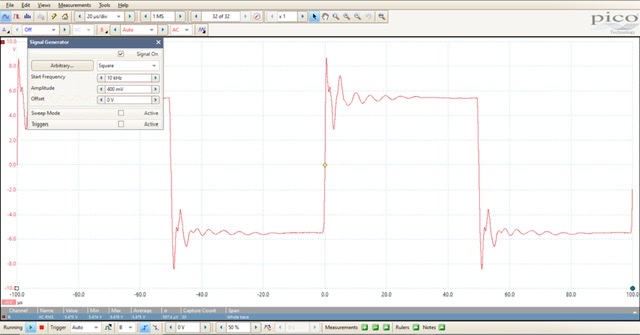

David, as an update on this, I just built the same thing, only using the Acro TO-330 outputs and EL34s. I will say that that bias circuit is tricky. I had to fiddle with it quite a bit to get the output tubes stabilized at the right operating current, about 65mA each. And if it's any comfort, this "stable" Williamson is anything but! Of course, the Acros are notorious for HF instability, whereas the Dynacos are probably a lot calmer. Even so, at first measurement I couldn't attach a probe to the input without the thing going haywire. I modified it with my all-purpose, rather aggressive HF rolloff filter at the input (1200pF + 820) and it was stable with .22uF across the 8 ohm load. Here are some pics, first the stock circuit at 10kHz, then the stabilized version, and a frequency plot of the stable version. You can see it's still "singing the mass" out to 100kHz, but it's flat to 20kHz. The red line represents the phase shifts.
