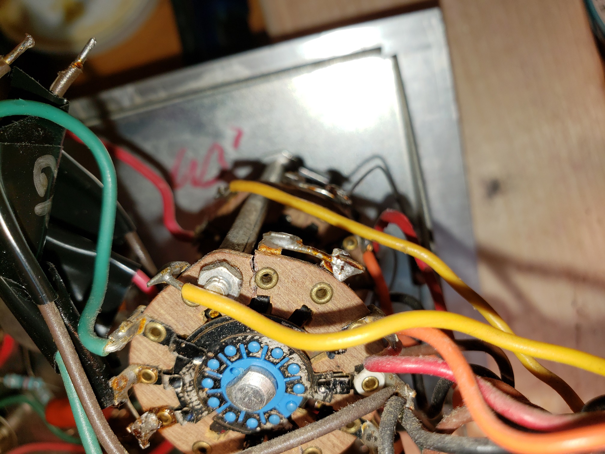

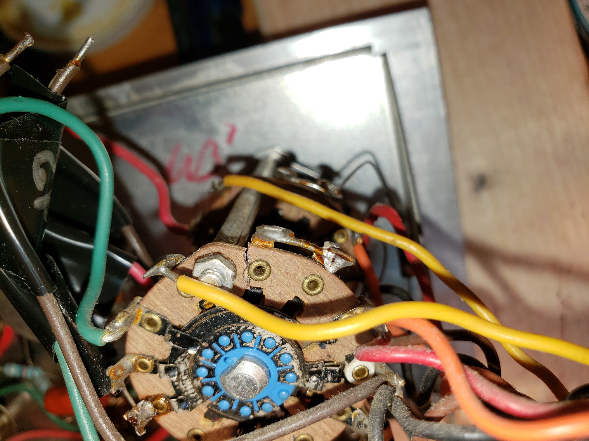

After looking at my progress pictures, I see that I broke the switch. As careful as I thought I was being, the bending moment from trying to neatly remove those 10k resistors obviously broke it.
Here are pictures of the damage and a section of the wiring diagram.
Thanks again.
PostPosted: November 5th, 2020, 5:25 pm
Another useless pic

Hey Stu! Since the break is out of the way of any electrical connections -- and at the end of the wafer right at the mechanical connections -- I think you have a shot at a successful repair. Also I recommend cleaning the silver oxide off of the electrical connections.
