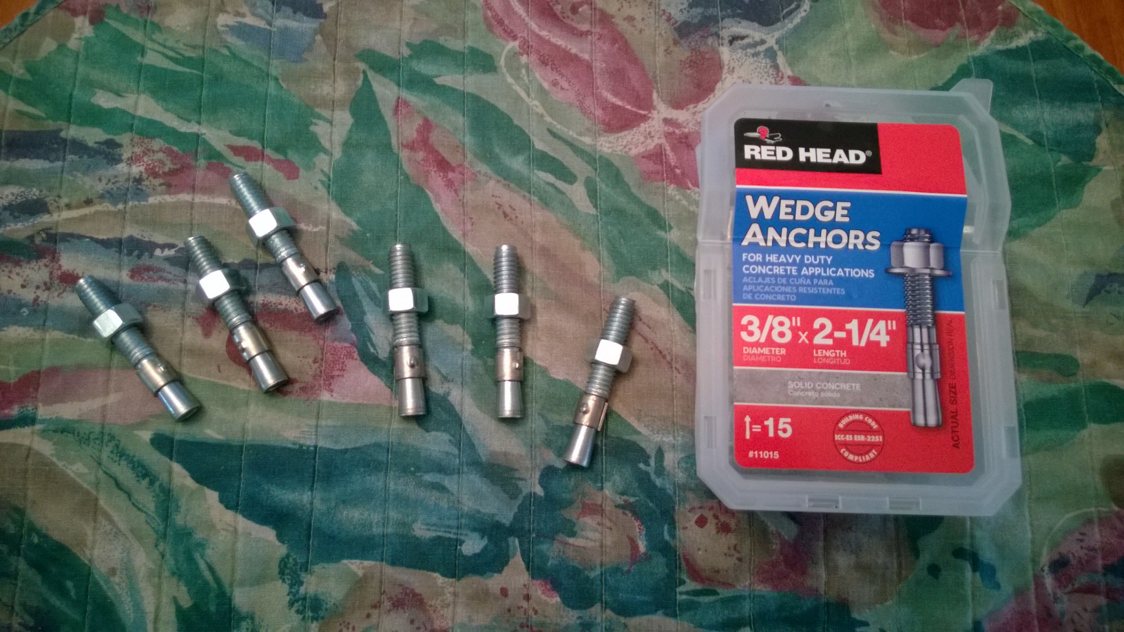

Decided to put some leveling feet on the baffles and wings, so here are the 3/8" wedge anchors and bolts to use on them.

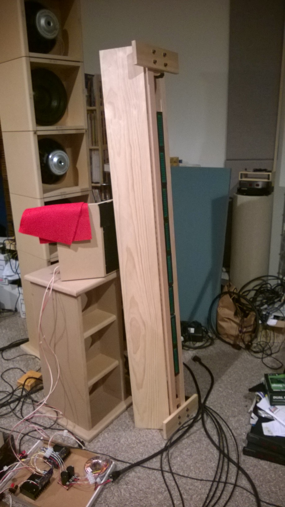

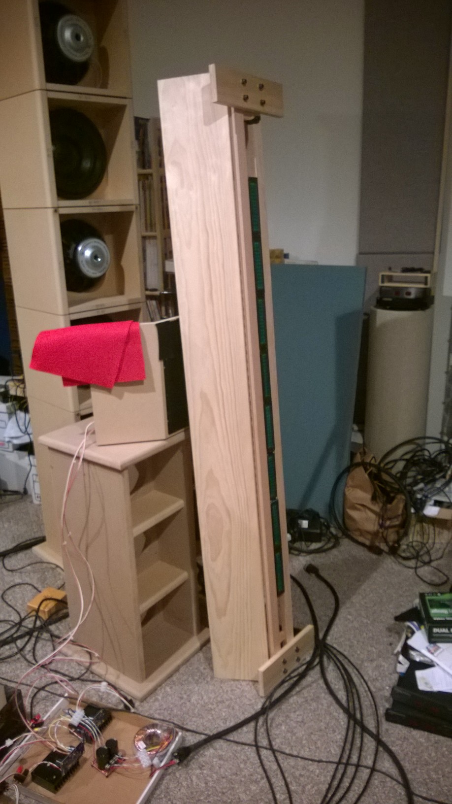

With some DAP Blue Stick the FPS drivers are installed for testing until the square drive #4 wood screws arrive.

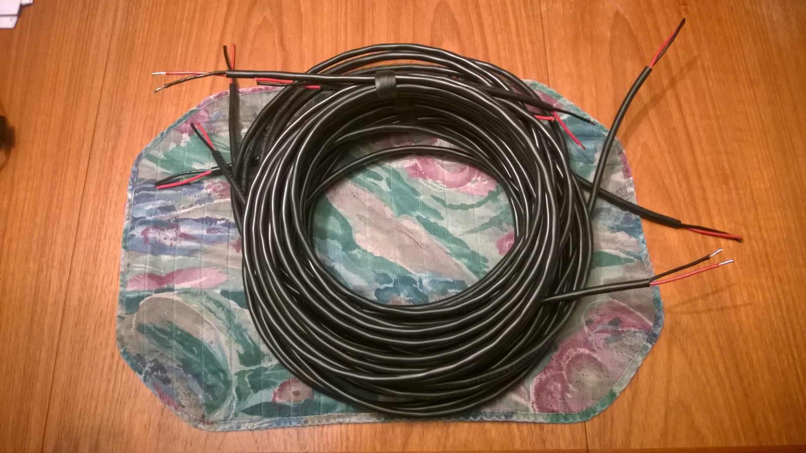

To make progress on the measurements with the drivers I have, here are the 6 cables to connect the FPS drivers to the moded ChipAmp outputs for the one channel. Next get the Fast On connectors and crimp them on for the drivers.

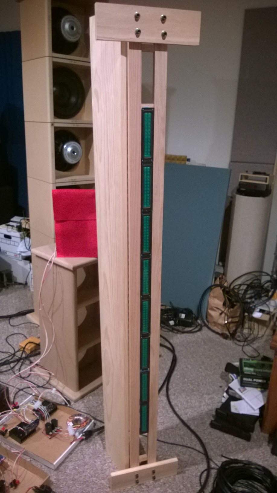

PostPosted: April 12th, 2016, 3:23 pm
Posts: 943

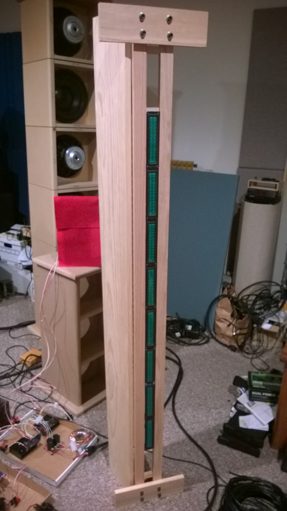

First FPS line array with wired planars ready to be connected to the amps.
This will be all I can build until PE ships me the correct matching FPS drivers. They are shipping the remaining 7 correct ones in stock and have 3 backordered to replace the 10 incorrect ones I have.
The Blue Stick is barely holding the drivers, so not sure if I have to wait until the #4 wood screws arrive.
Now to see if I let the magic smoke out when I apply power to them all. :shock:
