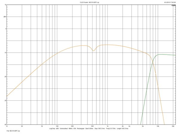

Received my Pocket CLIO system from PE today and set it up on my Netbook running Windows 10 64bit OS. Took the frequency response measurements for the open baffle planars using the BG NEO3PDR and NEO10 planars with the 6x12" servo subs. This is an overlay of the midrange and tweeters crossover responses.
Once I get the FPS line arrays running will see what crossover is needed with them.
