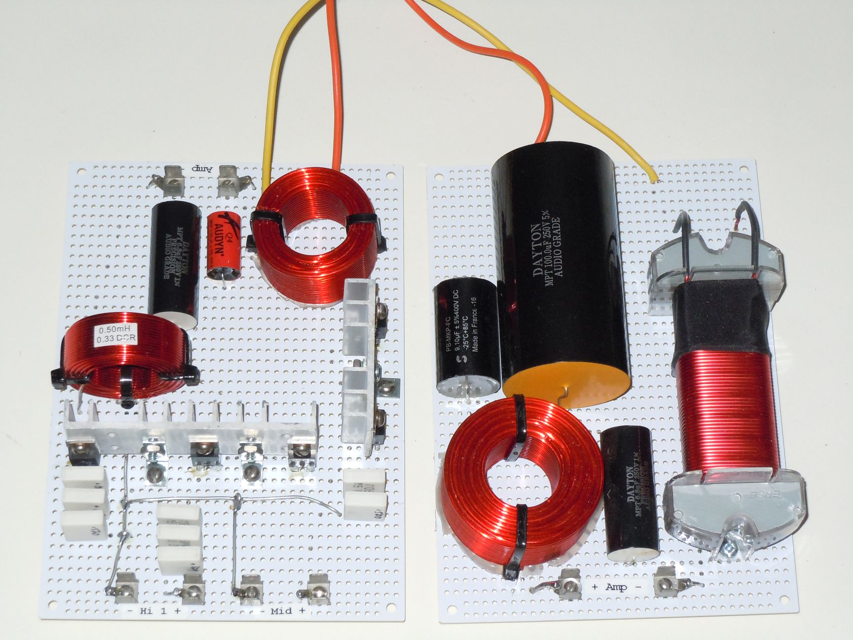

When I receive the stuff, how do you install/mount them?
PostPosted: December 29th, 2018, 4:57 pm
These boards are what I used for the egg crossovers. They come in different colors and sizes and make placement of the individual components easy. You can also drill holes at the corners for spacers and screws to mount them inside the speaker cabinets.
https://www.parts-express.com/white-per ... 7--260-190
