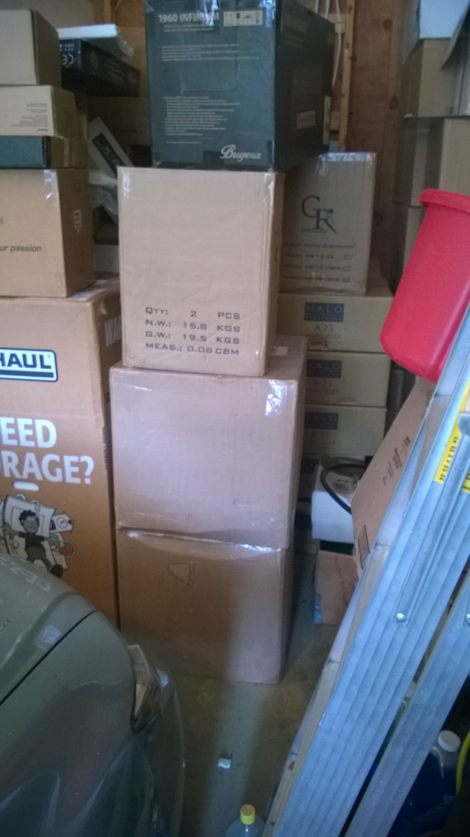

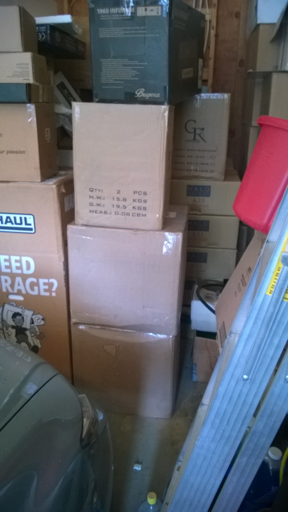

Everything is here and in storage until after the holidays and start building in early January.

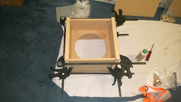

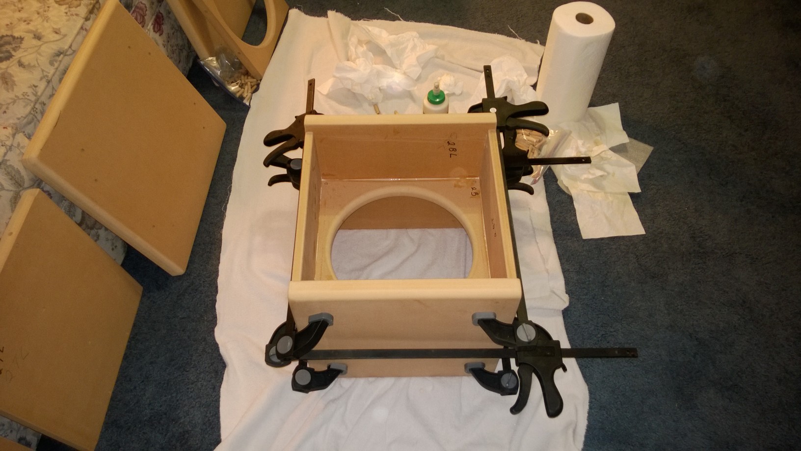

Servo sub modules #1 and #2 glued today and drying overnight. Working on #3 and #4 tomorrow.

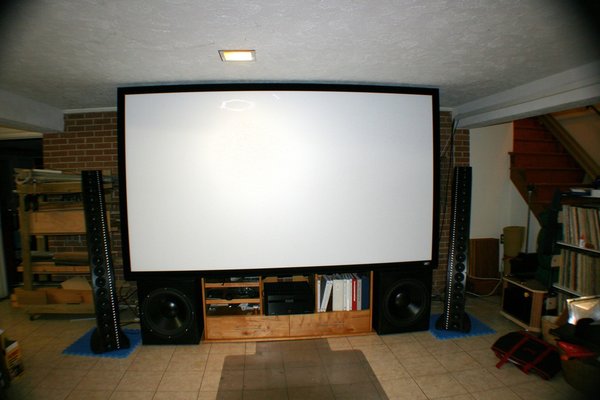

If you want an easy way to finish mdf (black) I suggest the following.
1. Sand the hell out of it with progressively finer sand paper.
2. Cover all the surfaces with a large indelible magic marker (black).
3. Finish with shellac with black dye added (shellac and dye available at the Woodworkers Club).
4. If you have surfaces with sharp edges use matte black Formica (order from Home Depot) applied with contact cement and cut to size after gluing on with a guided bit trim router.
Example above. Front surface finished with 1, 2, and 3. Back top and sides finished with 4 (actually all sides of the subwoofers are finished and all but the bottoms of the CBT36k's are finished).

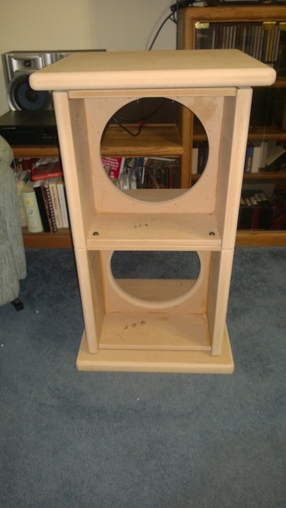

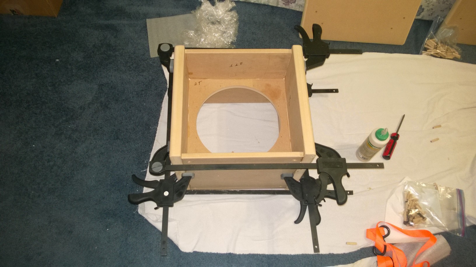

Test fit the first cabinet together and looks good. Time to build the second one. Now that Snowmageddon is here probably not going anywhere soon.
PostPosted: January 4th, 2018, 9:48 am
For open baffles glue is enough since the forces on the joints are not great. If you are using mdf for a closed box system in addition to glue I would use confirmat screws.
https://www.amazon.com/HighPoint-Confir ... B0031TGSB2
They are especially made for mdf.
