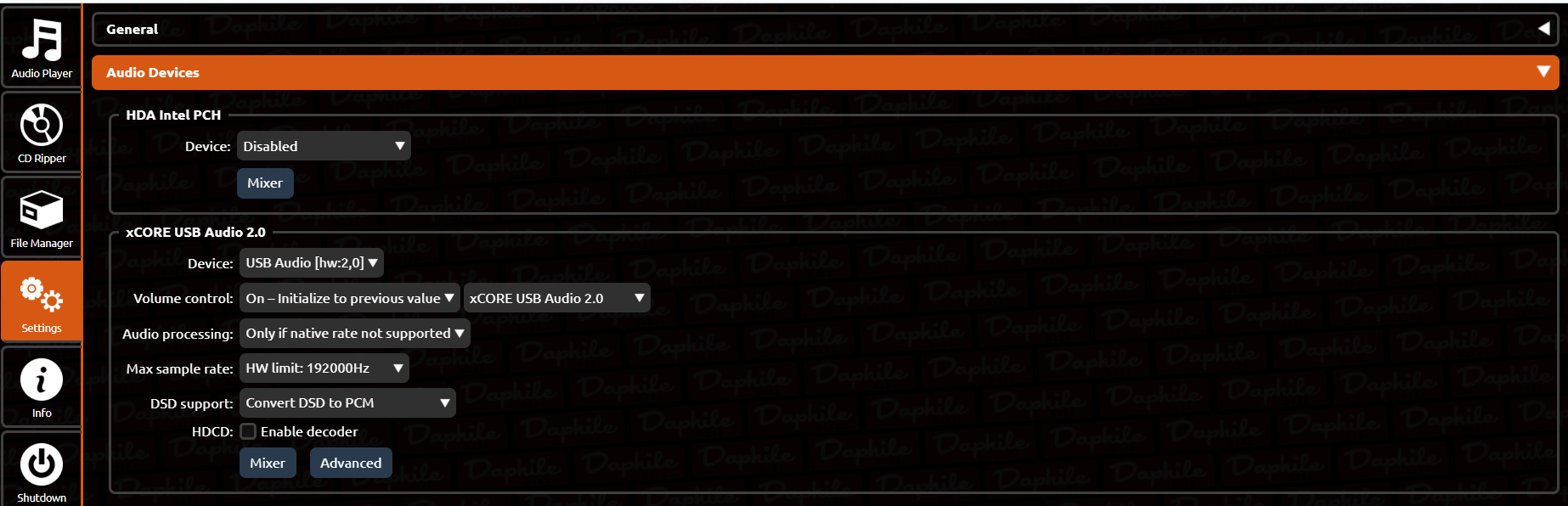

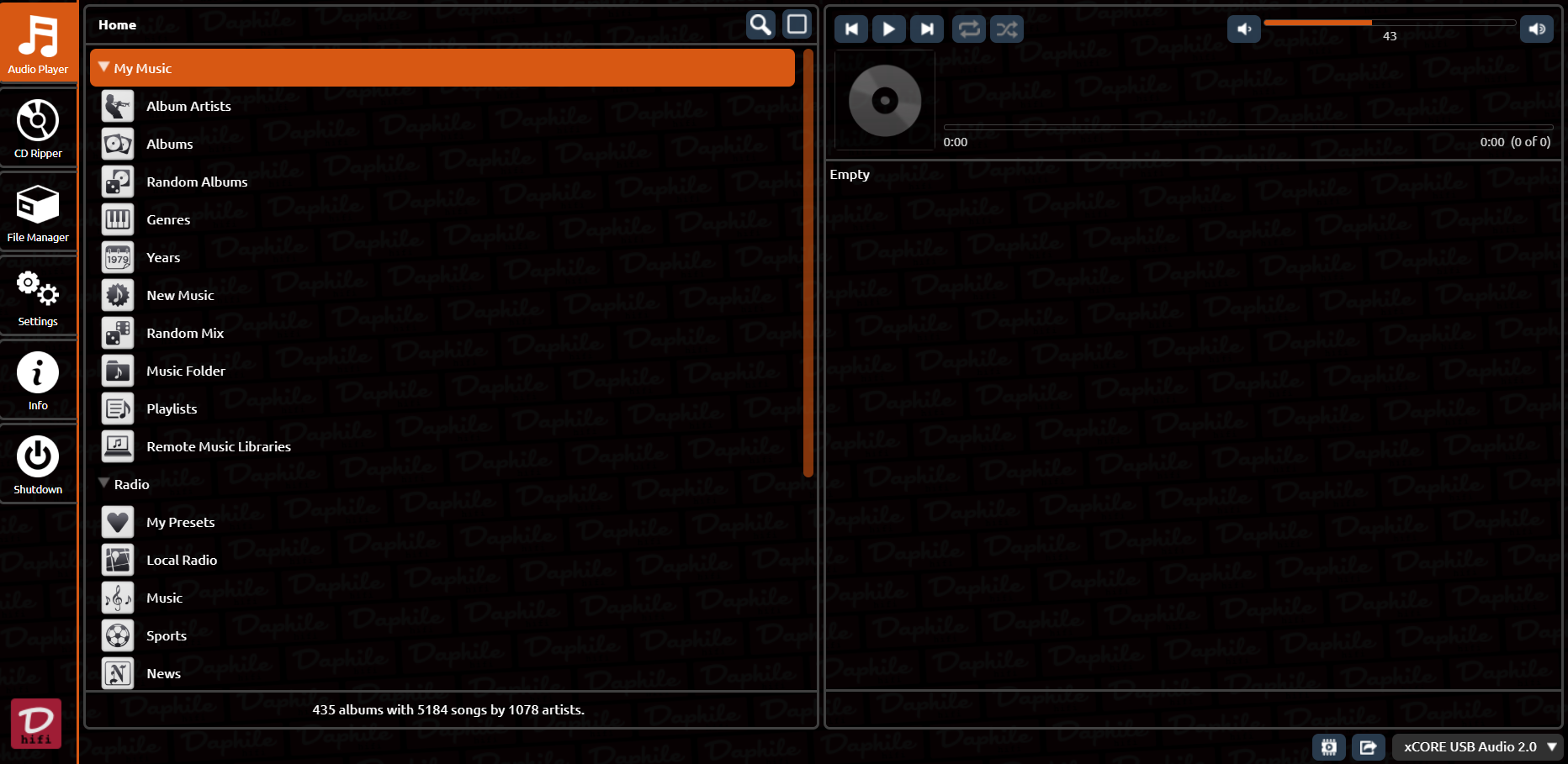

The output selection is on the lower right corner. There are also lots of selections for output parameters under settings. Not all of them are shown in the screen shot. I use it to drive the USB input to my DEQX Express II and it works very well.
