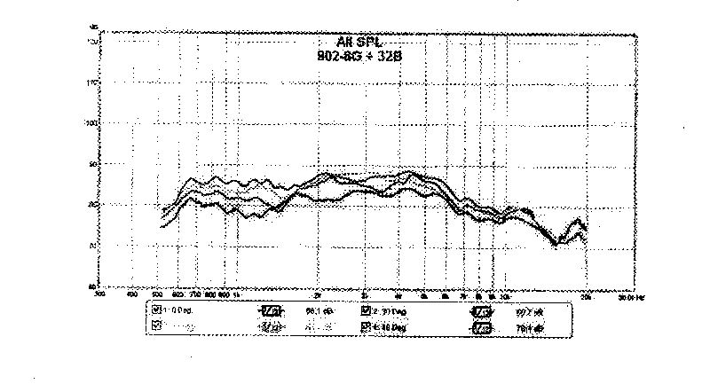

Anyway, here's a sweep of a 32 and 802 combo that I found somewhere online. Forget where, maybe Earl Geddes or Zilch. This EQ looks good to me for a natural "hall" sound, if one can deprogram the modern hifi listening habit and get into it for what it is.
I suspect this is exactly the sort of response that Bell Labs scientists were looking for when they developed the WE32A. Looks a lot like the response of a WE 728B, in fact. and a lot like what you will see if you tote your RTA down to the Kennedy Center

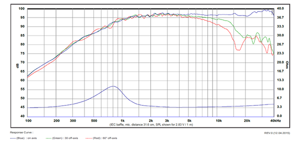

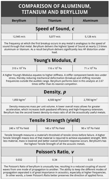

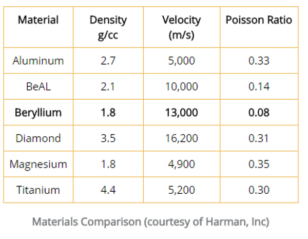

"So, I am of the mind that a bad tweeter is worse than no tweeter, and even a good tweeter must be applied with care ."
Amen to that Joe. Many tweeters that go out to very high frequencies suffer from at least two problems. The first is that the materials of the diaphragms (cones, domes, etc) have poor characteristics to deal with high frequency reproduction. The second is there is often an impedance mismatch at the terminations of the diaphragms that leads to energy being reflected back into the diaphragm causing resonances. That generally accounts for the resonances you see in titanium and aluminum cone tweeters. A similar thing happens with paper and cloth although both of those materials tend to damp the resonances to a greater degree.
I'm including two references that may be of interest. Also if you look at the response of the tweeter I'm using in the "eggs" you will see that there are no resonances out to 40K. It does sound very smooth although if it had a problem at 40K I couldn't hear it anyway.
