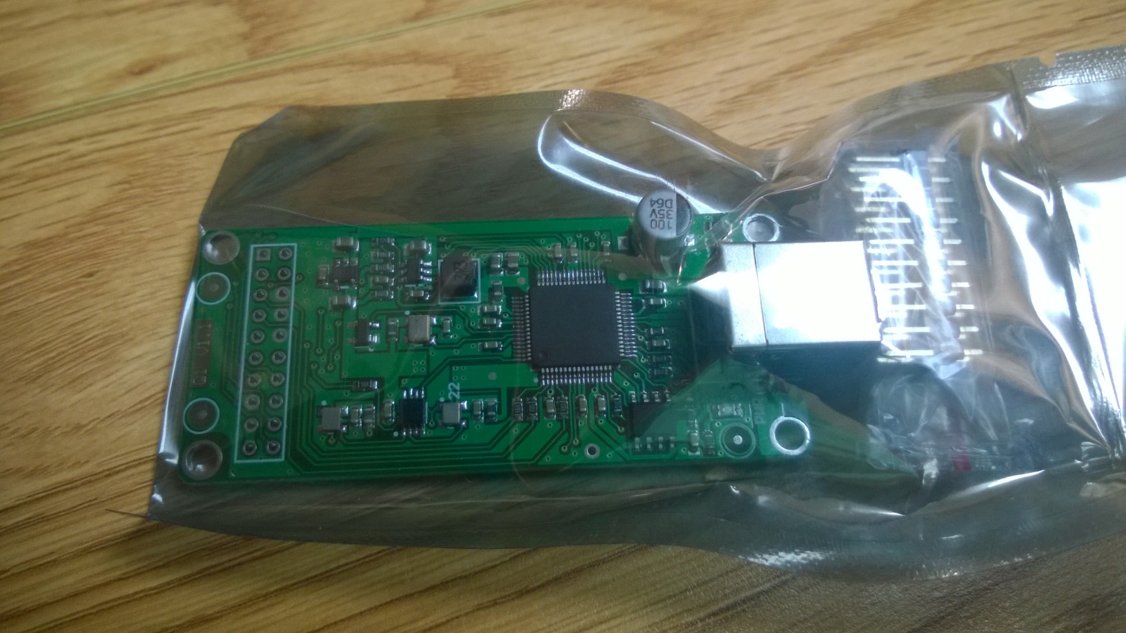

The USB to I2S Bus adaptor arrived after the second box was shipped. Took 45 days in total.
This is the XMOS U208 based board from eBay.
