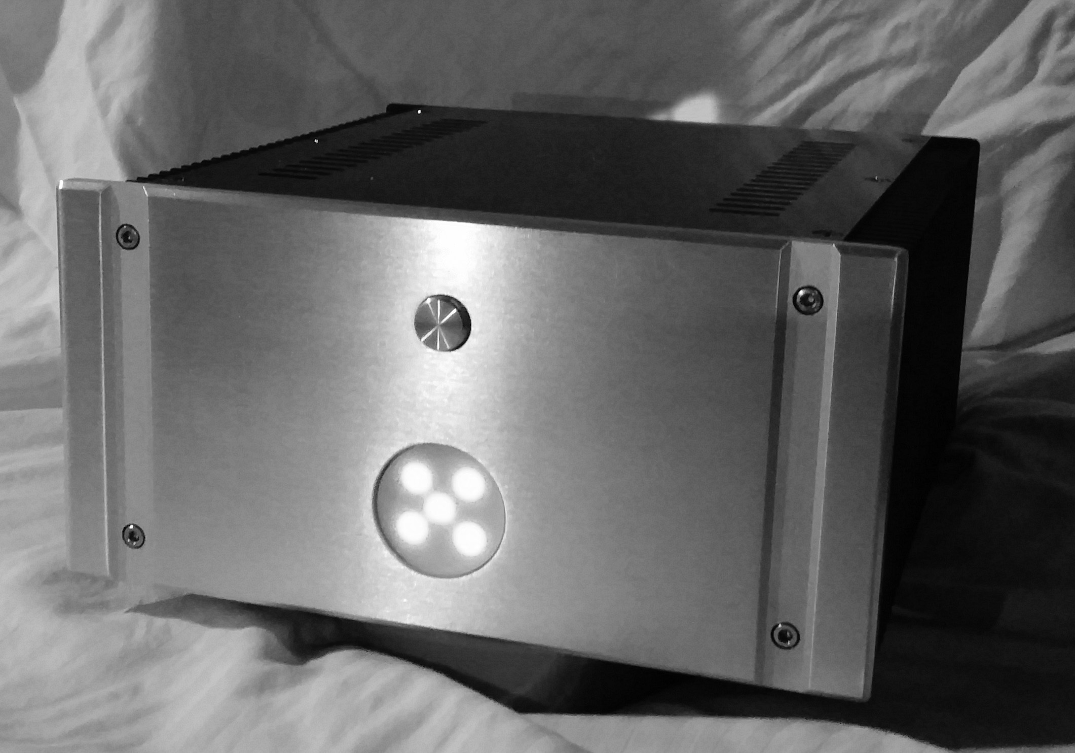

I've made several of a somewhat similar type amplifier, using (in most cases) Triad chokes. There is to be an article soon in Linear Audio magazine about a previous version (good for about 20W/ch). The latest (and probably last) amps I made that way do about 60W/ch/8 ohms, SE class A, no global feedback. Because of the choke, and some tricky circuit design, the efficiency is about 45%, quite good for a SE amplifier I think. The heatsinks are surprisingly small for a fully-class A of that power. The steady state dissipation is nearly identical to that of an old McIntosh MC60 amp in fact. The output devices are source (or emitter) follower configured Sziklai pairs ("CFP"), so the output impedance of the amp is still quite low, as is the harmonic distortion (under 0.1%, primarily 2nd order, with a little 3rd order, much like a triode's).
