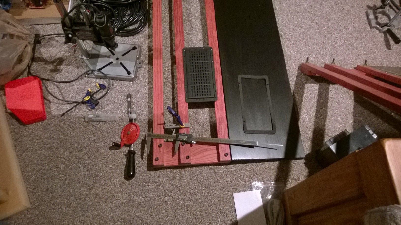

The calipers are working again, so time for some drilling.
Going to use the Neo10 as the template, mark the holes and use the V-Drilling guide clamped in position with the hand drill to do the first driver. Wrap it with Glad Wrap and then install it. Then stack the second driver and repeat the process.

After really looking at the Neo10's, they have slots for the mounting screws, not just holes like the drawing from BG. The FPS planars had holes for mounting screws, so they were tough to get correctly drilled. These have more adjustment range, so this drilling method should work fine.

BG Neo10 install has started. Using the Neo10 as it's own template, mark the center of each screw hole with a nail set. Remove the driver and drill the hole with the V-Drill guide. Install the Neo10 gasket and then wrap in Glad Wrap. Use the #4 square drive screws for mounting. Leave the Glad Wrap until all the drivers are installed for protection.
First two drivers installed and 6 more to go for the first side. This is going to take awhile!
