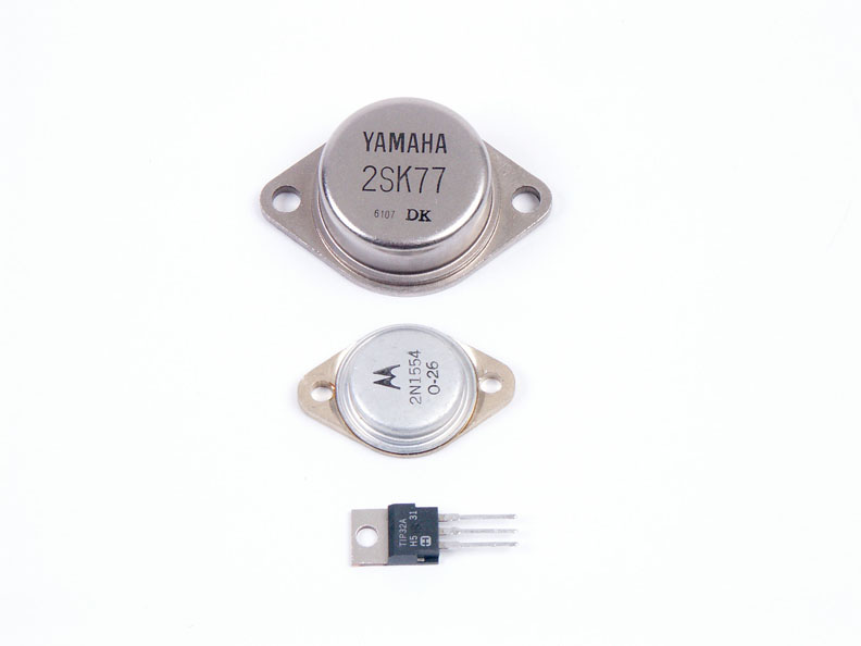

Finally, success. David Berning and I have been working for several months now to produce a truly unique and interesting amp. It is a choke loaded Single Ended Transistor amp using two Yamaha 2SK77 VFET transistors I found in my parts bin. I have had them for about 40 years and forgot about them until recently. When I brought them over to Dave's we ran them on his curve tracer and lo and behold they looked similar to a 300B.

I'm including three photos, the 2SK77s in comparison to a TO3 and TO220 transistor to give you an indication of the size of the beast, The underside of the amp showing the circuit board, and the completed amp. SInce this is a "retro" project I decided to paint it with a metal flake glitter paint called "cherry bomb" for effect.
