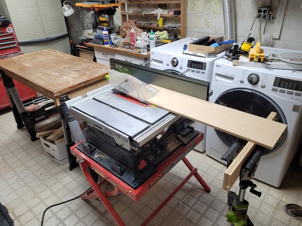

Thanks for the offer to use your shop, though I doubt I will be undertaking a speaker project anytime soon. I do have a Bosch portable table saw that I recently rebuilt the motor on, used an extended fence, infeed support and flat outfeed for a few cuts on some rips that I used, but found that the Makita plunge track saw was much easier to manage because the work was stationary, and the TSC parallel guide system ensured precision and repeatability. With a shop vac hose attachment on the saw, there was virtually no dust. Of course I cannot say that about routing...that was a big mess and took alot of time. I needed to take some of that outside, the dust was so bad. I have a Jasper circle template, a 1/4" solid carbide straight bit, and took cuts 1/16" depth per pass to avoid any tearout issues. So did just fine with the tools I had, planning in advance for each operation to ensure no mistakes. I think it is important to know one's tools, what they can do, and adjust to their limitations. Where there is a chance that that something could go awry, rethink how to do it, test it first, and then proceed with care and confidence.
