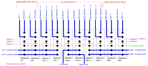

Four inputs, reed relay switched, and two outputs, one effectively high pass around 100Hz with my crossover, and the other full range. Two inputs are balanced, two unbalanced.
A 4PDT-CO switch is being used as a phase reversal and mute switch.
Each channel has a separate gain control. They are 100k stereo stepped attenuators (from eBay). Very small and they use surface mount resistors. Should provide very close tracking +/-.

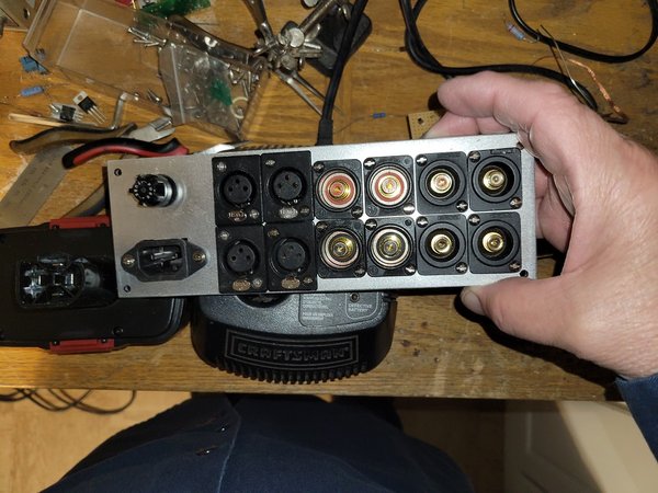

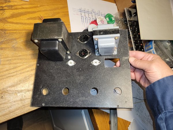

Using a chassis from an abandoned project: hardwood sides and 1/4" plastic top plate. So, yeah, true to form, it's not pretty!
Basic construction is done, creating circuit boards now: high voltage, low voltage, relay and amplifier.
