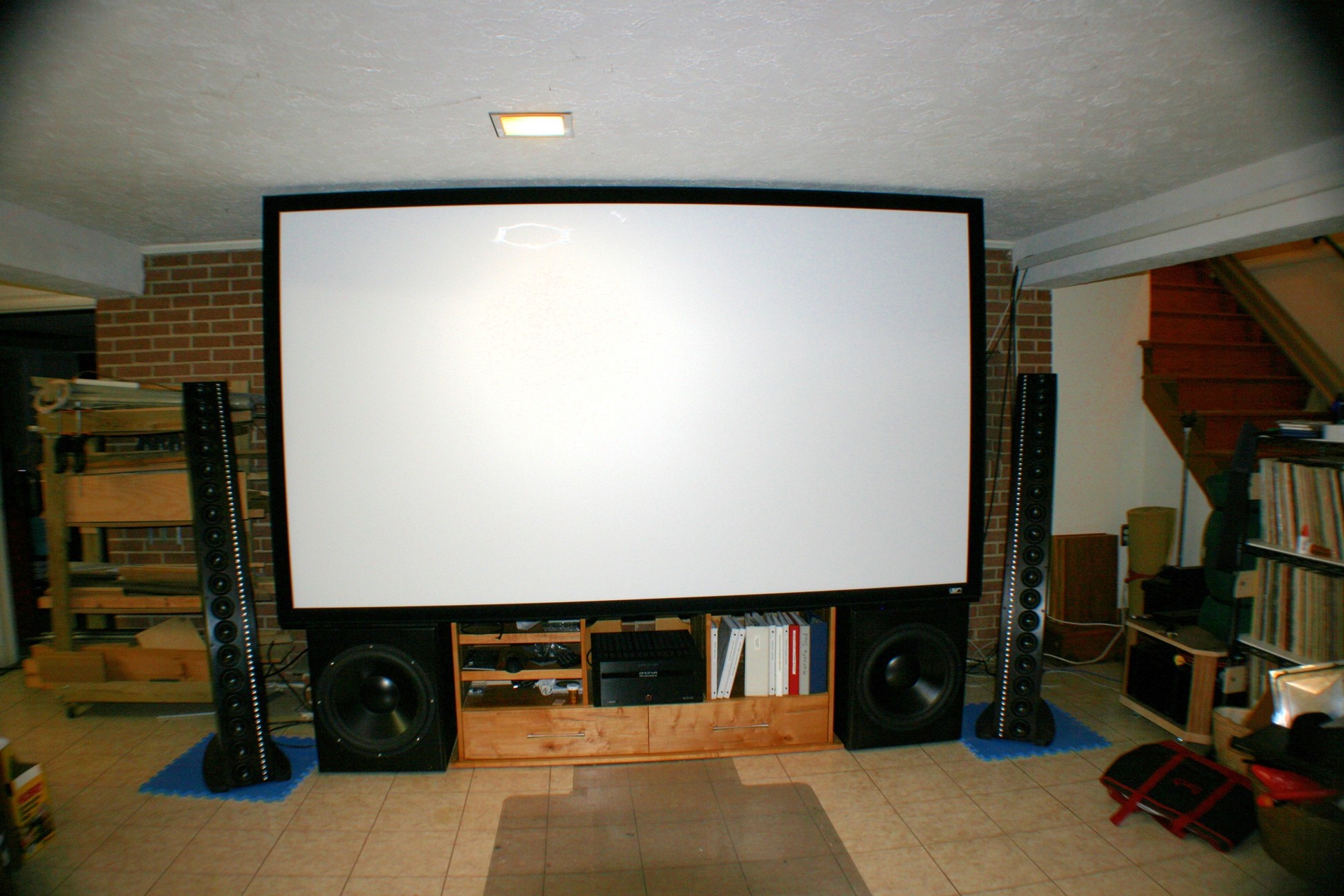

The are cases where you can drive the tweeter(s) directly. Consider the following system -
[attachment=0]
Each array has 18 midrange drivers an 72 tweeter drivers. Each of the four arrays is driven directly by an Emotiva XPA-4 (4 channel ampilfier). The system has been in use for several years with no problems. The Emotiva amps have a soft turn on and turn off. No problems even when the electrical line craps out.

Still a risky situation for a tweeter without a blocking cap. I quad amp my system with no passive devices in series, but I also have a custom speaker protection circuit in case there is DC or the total power is too high. It saved my bacon one time when a driver transistor in an amp failed resulting in the amp swinging the output up to the DC buss voltage.
