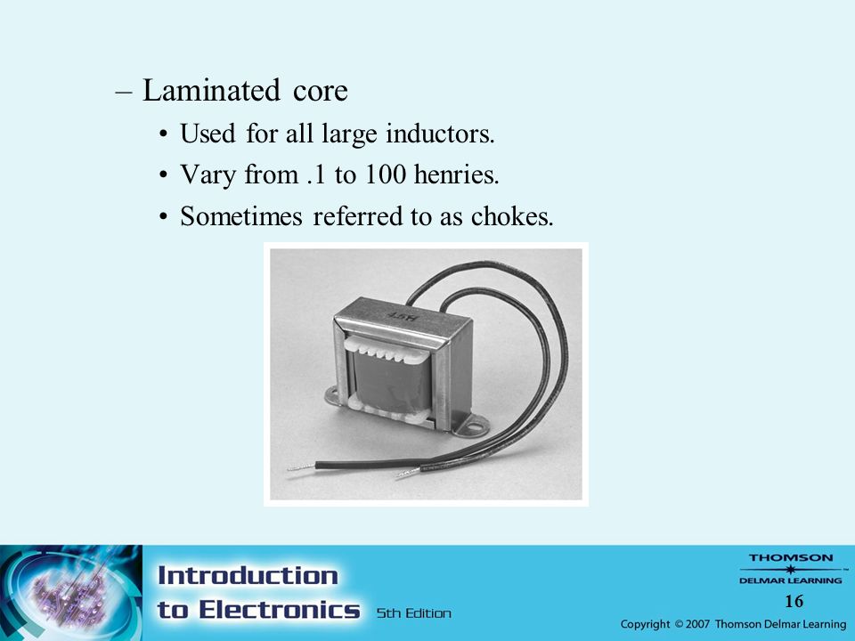

Actually my experience and that of Wilson Audio has been that the best results are obtained from laminated-core inductors. :thumbup:

I have used the Erse laminated core coils with great success.
https://www.erseaudio.com/Products/IQCoils

I wanted to go to Ersa because they are much lower cost than Solen. The values I needed were back-ordered with no date of availability available.
I pulled a few strings to get the Solens at resellers' cost which was still more than the Ersa.
I know that conventional thinking is that one can get away with iron core inductors for the bass. But what I heard was a very significant gain is speed. Before the bass was a bit thick. Now it's quick like a bunny.
I find it interesting that most people (including me) do not enjoy the sound of Wilsons yet here you are using them to bang on my head.
