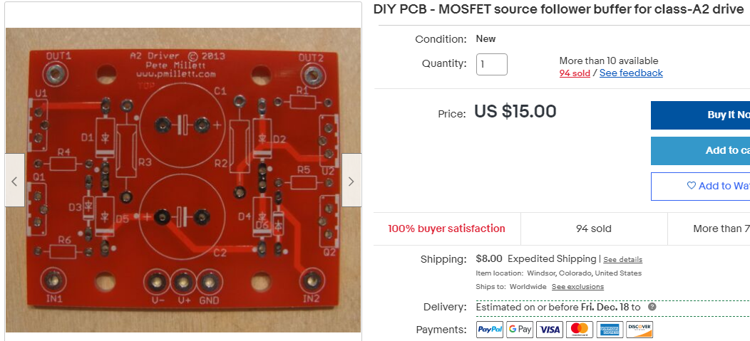

Curious why you chose to drive the screen from the plate of the voltage amp, rather than use a follower (SS or tube) direct coupled to the grid with lots of standing current and a very low output impedance? Was it simplicity, elimination of a third stage, or other reason?
Slick
PostPosted: December 11th, 2020, 2:29 pm
Posts: 1734
Slick
Simplicity. Also, the choice of driver takes that into account, with about 45mA of standing current....
