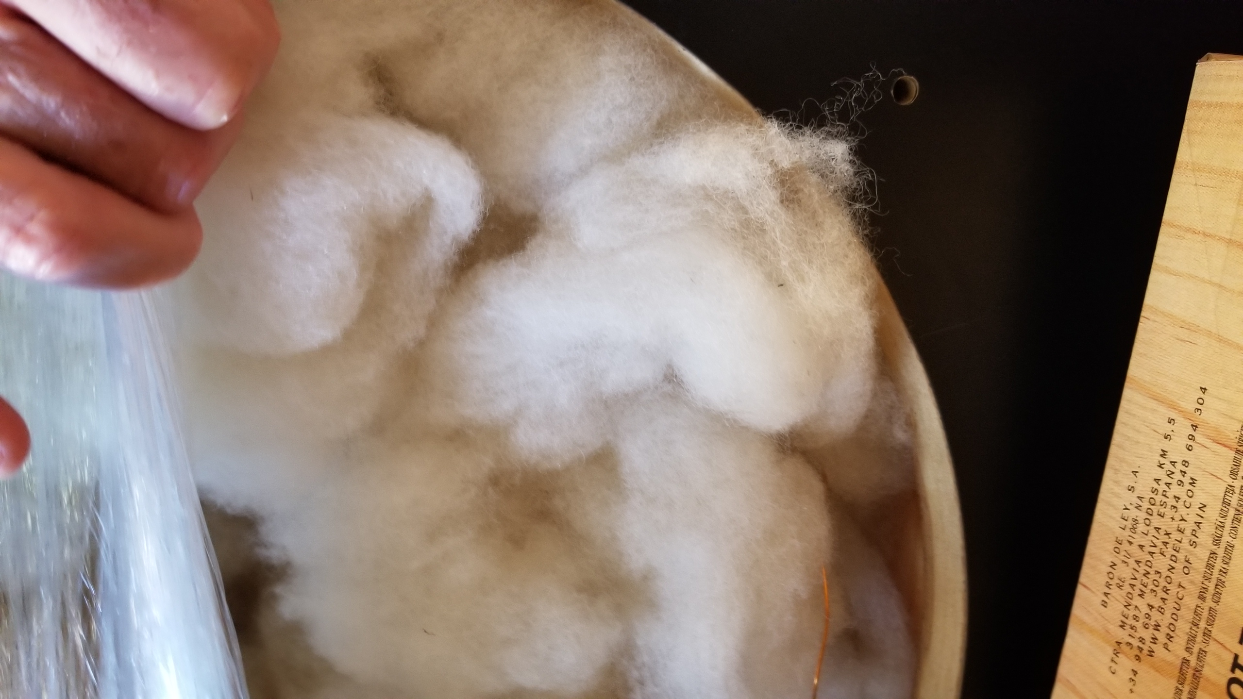

Yes, in my case. I'm sure the technical side as Tom said is right, it's changing the woofer's parameters, but what's audible in my case is perhaps less resonance and reflection.(?) My speakers have 2- 15" woofers and 1- 18" woofer per side, all lightweight pulp/paper cones. Certainly, less time smear from the port/vent as the level is quite low. Perhaps, the damping is reducing overshoot also?
I added a pound at a time (large cabinets. 12 cubic feet for each full range and 8 cubic feet for each sub.) until I got the sound I was after. Picture shows how it's packaged and in the box. Kinda looks like cotton candy.

A word about Jim's choice of fill. Wool (what Jim used) and fiberglass are the fill materials of choice. They are not reactive -- PERIOD! Polydacron fill and foam as used in bedding, is reactive, and works counter to the goal of damping.
There is course polydacron fill that can work -- but most of what is sold in fabric stores is the fine fluff -- the coarse polydacron is difficult to come by. One other fill material that I really like a lot is raw cotton -- right off the vine -- seeds and all.
I've used cotton fill in the past and liked the end result.

True enough. My full range speakers came overstuffed with polyfill from the factory by design. 2 woofers sharing the same 12 cubic foot vented cabinet as a 2.5 way by design. The wool, (suggested by a friend) was an immediate (subjective) improvement.
