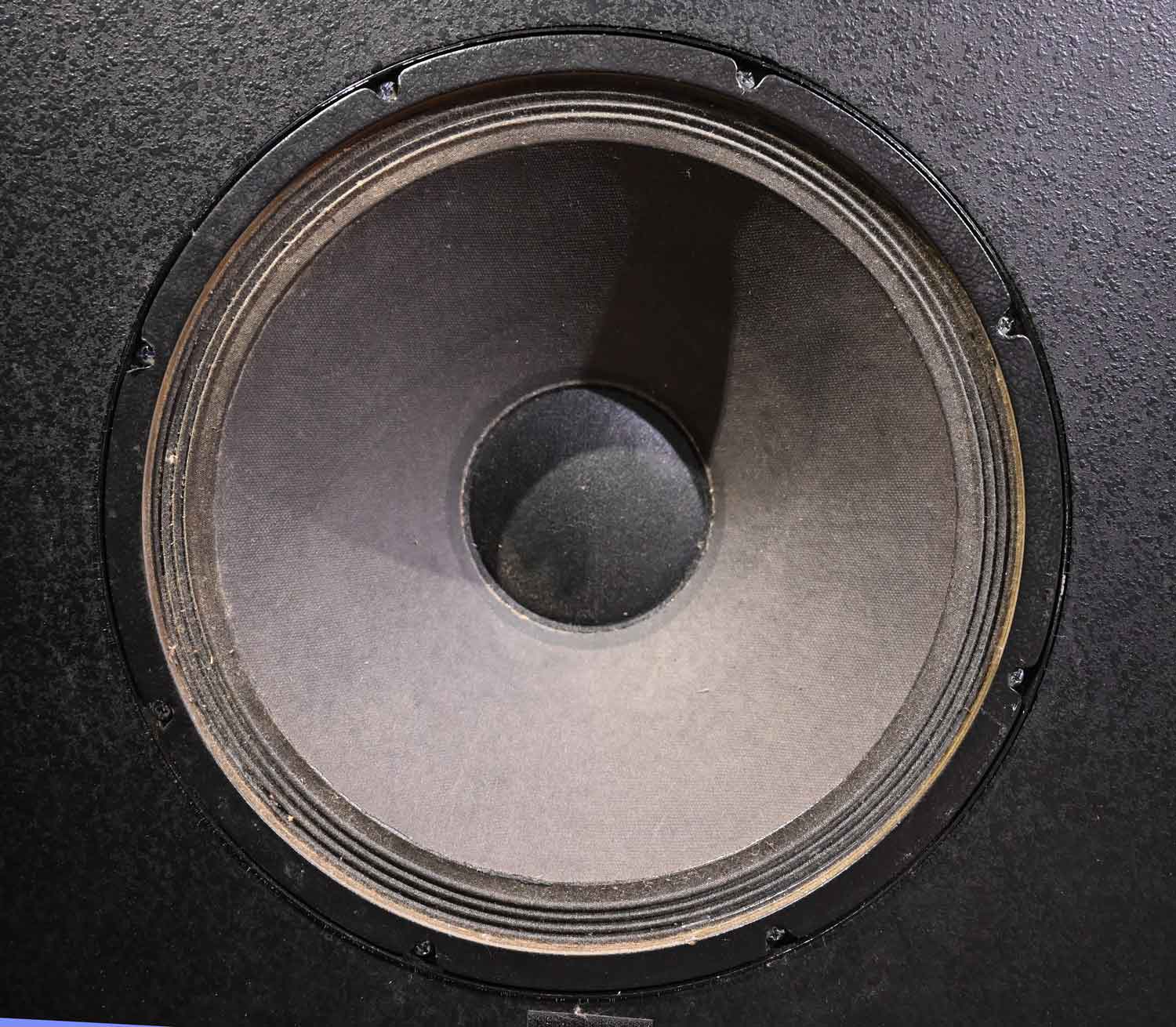

So I finally dragged these out to check them out to get them ready to sell. One of them had something rattling around inside. I removed the woofer screws but I could not it out, it was stuck hard and not wanting to damage anything I removed the mid horn, which came out easily.
I found the mid horn s wires just dangling and one of the coils had come loose from the crossover board.
That was fixed pretty easily and a quick inspection I found that the box is well made with one brace between the front baffle and rear. There was no filler, which surprised me. These are pretty heavy.

I find it hard to believe Klipsch put this in crooked like that. Someone had to have had it out at some point....
This is a great project for someone who wants to take the time and effort to build decent crossovers, and possibly do something different with the horns if the price is right.
