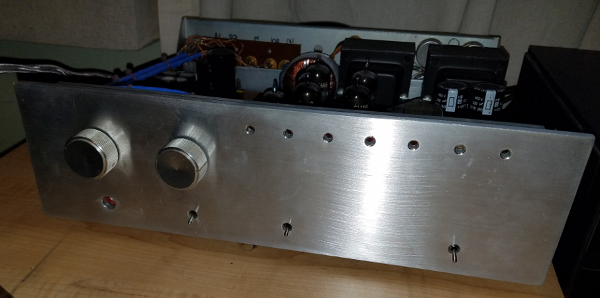

I used a similar product a few years back. Works well. Used a 4-gang Alps motorized pot. Paralleled sections to net a 25k pot, but with two wipers per channel.
The one posted should be excellent for a simpler build.

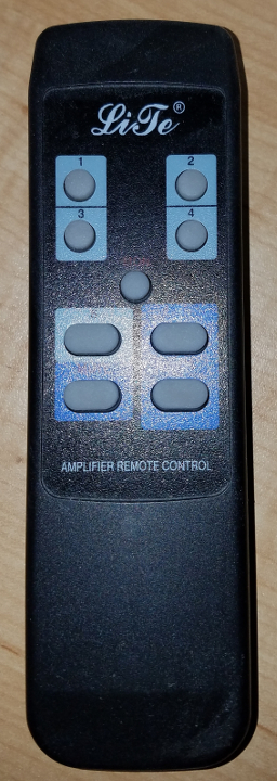

The remote
